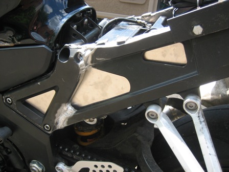

Originally Posted by 00GSXR750
WHAT UP BRO , CAN YOU POST PICS OF THE CLUSTER MOUNTED AND THE HEADLIGHT MOUNTING, ALSO SUBFRAME REINFORCMENT ALL YOU NEED IS A SMALL STRIP OF STEEL WITH HOLES DRILLED IN THE END TO CONNECT THE PASSENGER FOOTPEG TO THE DRIVER ONE
Ive got my fairings back on right now but I will see if I can dig up pics of the headlight mounts. I will take pics of the subframe this afternoon when I get off work.
Once again, in my opinion having snapped my subframe twice you can not use the conventional re-enforcement techniques such as adding a long bar mount or running a link from the pax pegs to the rearsets.

I really didnt want to take the subframe off just for pics but when I have it off next I will get some better shots. To re-enforce it like I did you first have to grind all the little round nubs off the inner face of the subframe so it is flat (those of you with 04/05 gsxrs will know what i am talking about). Then I took a piece of paper and traced out the outline of the subframe. This is transfered over to a piece of 6061-T6 Al (I used 0.050) and trimmed to fit. You will have to put a couple of bends in it to make it fit correctly but a rubber mallet does wonders. Then, clean off the subframe to bare metal where the welds will be and have at it. It is a bit tedious so if you dont have a nice tig rig and time dont bother unless you want to hire someone to do it. It is VERY stiff and has no flex. Those who have seen it here in MN can attest for that. I have hit it plenty hard multiple times without problems yet. Good luck- A few pics are below. It wont get paint untill winter.
ID:	172200   Click image for larger version
ID:	172201   Click image for larger version

I am thinking about running arms from the rearsets to the pax pegs like everone does on the older gsxrs because with the current design the load may eventually break the subframe at the lower mounting holes. I havent had problems yet so I wont bother but I will post up if they ever break.
