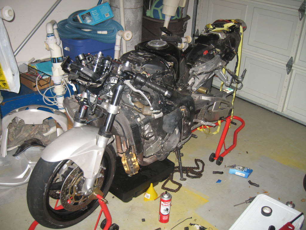

For those of you with an 03-04 model 600 RR (may work for 05-06, not sure havent cracked one open but im sure its about the same) here are a few quick pictures i just took after doing this. hope this clears some stuff up...
This is about what it looks like once you pull the airbox off, maybe less dirty haha. As you can see there are 3 hoses coming from the cover, these all stay connected. One hose is connected to the valve and airbox only, pull this and discard for now. The other hose that was connected to the airbox will still be used as its one that is connected to the cover.
I didnt get pictures of this, but in the valve are two little screws. pull those screws out, be careful of the rubber washer/gaskets within, but seperate the 3 pieces of the valve. remove the plunger and the spring and reassemble.
Now, you have a T valve. My hoses were a little worn, so I cut a bit off the ends. be careful if you do this, if you cut too much it may kink a hose trying to get them all back together. I just used sharp scissors:
Now you take the three hoses (connected to the case) and run them to a nipple on the now empty valve. Make sure all the connections are good and the valve sits up under the hole. where the old hose used to come out in the frame for the airbox.
Now you have that part done, time for the airbox. On the underside there will now be two nipples that are open vents which lead straight to the throttle bodies... not good unless you like to burn dirt and debris as part of your fuel mixture. In order to plug them I went with the valve cap/electrical tape combo. I also put a little epoxy to make sure they hold tight. There are a lot of different ways (and im sure better ones) to plug the holes, but I figured this would work.
Anyway... sorry for the poor write up I just thought I'd let the RR guys know its a bit different than the f4i but not much, same basic concept just different locations.
by the way, im probably halfway to getting this thing to where i want it before i give stunting a try.... cmon parts get here!
