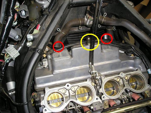

Sorry to drag up this thread, but I'm staring at my 600RR and I'm confuzzed... I would expect it to me somewhat similar to a 636 but I don't see a vacuum line that runs into the crankcase?? I'll post a picture in about 5 minutes

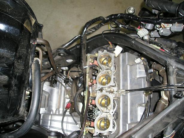

If you look in pic one, the yellow circle goes straight from there into the airbox, but the other 2 go to the kleen air valve and then 1 line goes into the airbox. I'm confused b/c I don't see a direct vacuum line going into the crankcase.

uh, big *** hose running from crank case to air box... think under the seat, back of the motor, crankcase = tranny basicly, oh man the race models have a valve cover breather, that middle one on the valve cover is it. i'd just slap a small filter on that bitch like you would to the ones on a honda car valve cover.
oh thats a honda 600rr!...

This is the 636 thread. No 600RR
Old May 10, 2007 | 09:32 PM
  #240
N/A's Avatar
N/A
Posts: 7,259
From: N/A
Re: kleen air on my 636-good idea!
ya i have a rr.. can anyone help?
