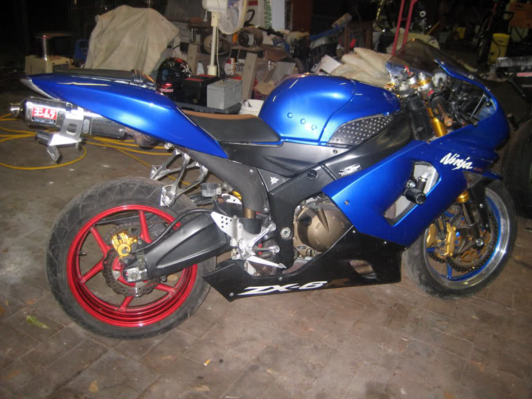

lol i just got my 636 last night. i know nothin about this damn bike and my head hurts from reading LOL but i think i got it sorted after seeing that first pic on the 2nd page... im gonna do the mod this week maybe ill make a youtube tutural for everyone.....
HERE IS A LITTLE PIC OF MY NEW BEAST
