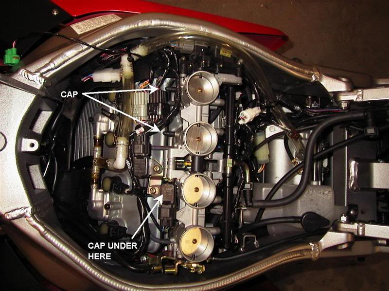

QUESTION: On the 636, the tiny tubes that come off the KLEEN system and run to the throttle bodies, do you cap those off or ?????? thanks!

i think u supposed to capped those off

Got it figured out, which lines to remove and what to plug. Now i have to figure out what to use as plugs, autoparts store closed...

Thanks bro, took a look at my bike and read that article carefully, got that all figured out now...
just need to find things to use as caps! lol
Old Jan 21, 2007 | 04:54 PM
Re: kleen air on my 636-good idea!
if you cant find regular vaccum caps you can just put a screw in the end of a peice of vaccum line....
the ones you took off maybe , or just t them together it does the same thing
Screw in the end of a piece of line... i have that! oooooooo, roger, u so smart! lol thanks!

And, Sorry I forgot to mention the caps on the throttle boddies. Yeah cap them i got lucky parts store had caps but I had to use a bolt in the end of the 1/2" line on the back of the airbox cause they didn't have a cap that big.

i just did this but i did not do anything to the throttle bodies do you have to or just cap the one little vacum line that comes off the kleen system
