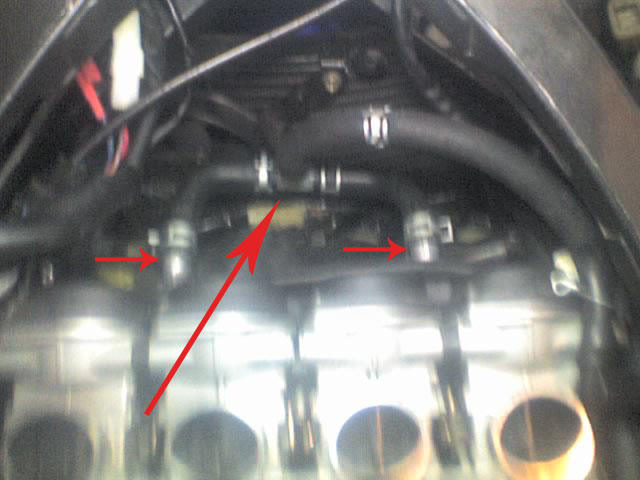

Old Apr 1, 2007 | 08:08 PM
  #217
BURN's Avatar
Joined: May 2006
Posts: 104
From: OH
BURN is an unknown quantity at this point
Re: kleen air on my 636-good idea!
Originally Posted by ry0s
get any yet?
not yet, sorry.....
been riding, and havent needed to take the take off. i'll try tomorrow, but no promises.
just wonderin, when you got the mod all hooked up, did you just disconnect the AIS or did you leave it there?
AIS? the intake? i had all of that taken out anyway. cause i had it streetfighter for a while...
got some pics, i'll get them up today.

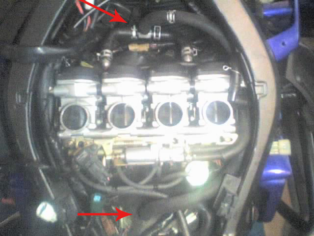

here ya go...sorry for the shitty cell phone pics, its the only camera i could get ahold of.
anyway, the red arrows show where the hoses connect.
the "T" just replaces the air valve, i re-used the L-shaped hoses that attach to the vavle cover. just un hook the plug for the air valve and zip tie it out of the way,
ran the large hose back to the crank case vent. just tucked the hose between the throttle bodies and frame.
it is really easy, hope it helps...
