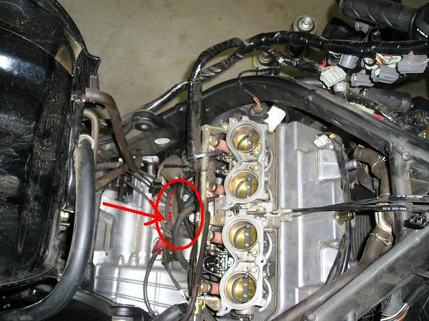

Mr. Farley If you look in pic one, the yellow circle goes straight from there into the airbox, but the other 2 go to the kleen air valve and then 1 line goes into the airbox. I'm confused b/c I don't see a direct vacuum line going into the crankcase.
Looks kinda like the way the f4i is set up on your 600rr too to me.
Doesn't look like you have a breather hose over the tranny on yours I didn't know the rr and 636 differ that much.
Anyway I just got an f4i and thought i would do a little reasearch on the mod for it too. It helps the low end torque on it too by doin this mod.
SO... I did it to my f4i and got good results on a much stronger idle.
I would say do it to yours wether you get oil in the airbox right now or not, It worked for me on my 636 and F4i as far as preformance.
Just take that factory diaphram off and plug the small vaccum line going to it. Then put a "t" on and connect the center vent to the 2 kleen air valves and don't forget to plug the hole in the airbox.
That's it! Yours is actually easier than the 636 because you don't have to run new hose and all that crap.

Wait man what is this hose and where does it Go? Is that a CC hose?

Goes to my stock vacuum idle... it's all part of that assembly. I just took off that whole clean air unit and just did a T from the outer 2 to the one in the middle. I just started it and ran it... feels good, the bike didn't throw any codes but I'll have to take it out on the streets and see how it feels.

I possitive you'll like it as long as you plugged the small vaccum line the unit was hooked to. Thats the one that makes the diaphram open but you won't need it anymore. I'm sure you already got that.
It'll seem quieter too but stronger idle fo sho.

The valve has 2 big vacuum lines coming into it from the valve covers and then 1 line that goes out and to the bottom of the air box. And then there is 1 big vacuum line that goes directly from the valve cover (the yellow circle in the my previous post) that runs directly to the air box. There was not any little vacuum lines anywhere to be seen?? I think I did it right b/c I started it and let it warm up and it seems to idle just fine and rev good, so I'll take it out here momentarily and see how it feels.
