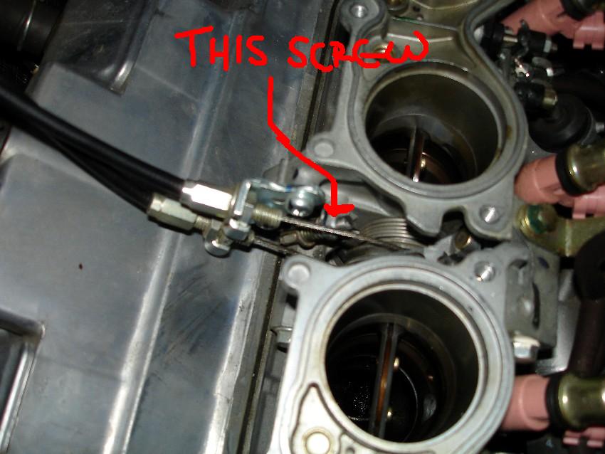

Alright so I have a 04 600rr and have it stripped down to the throttle bodies waiting to put in my second cable. It looks like the set screw is in a different position than the one shown in the pic of the f4i. I see 2 screws above my stock idle cable one is painted white im guessing these are the set screws which one should I remove.
i just did mine on my 04 for the second time cuase mine snapped...
where the throttle cables connect to the throttle bodies is where the set screw is you want to replace.
lookin at the front of the bike so the throttle is on your right and the clutch is on the left... now look at the where the cables connect. you want to replace the screw on the right...... you are also gonna need to cut the idle cable screw end shorter.
lucky for you i have a couple pics, hold a sec

in this pic you can see the end of the snapped cable... that is where you want to put your idle cable.

and an FYI for everyone else, the 600rr idle calbes are by far longer than the F4i's and the 900rr's......

Well im a bit delayed, went to Honda and the 900rr cable is on back order for 10 days so I ordered a 600rr cable, will this work.
yes, its actually better than the 900 cable cause its longer.... its what i used in mine
