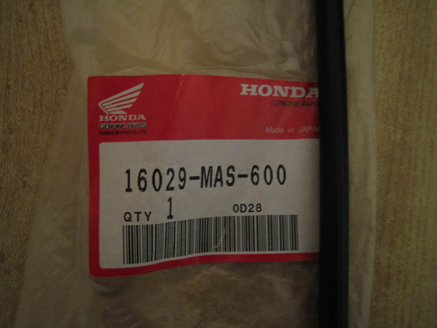

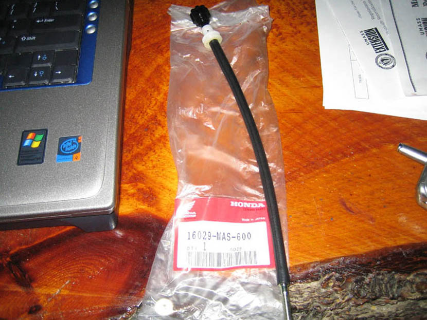

98 900rr is just a little bit longer than the f4i cable.... I think
ID:	165706   Click image for larger version
