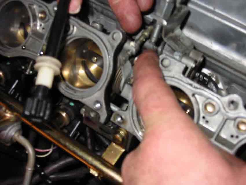

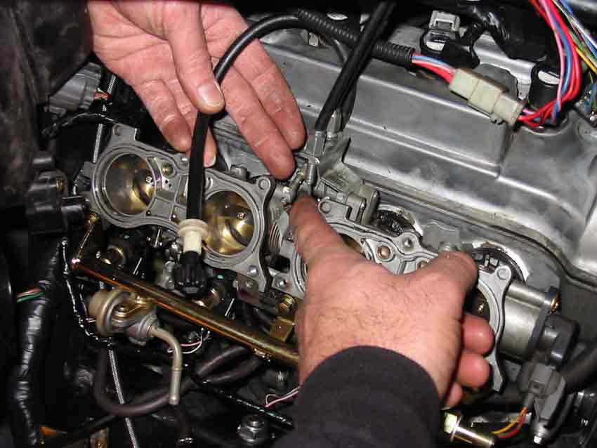

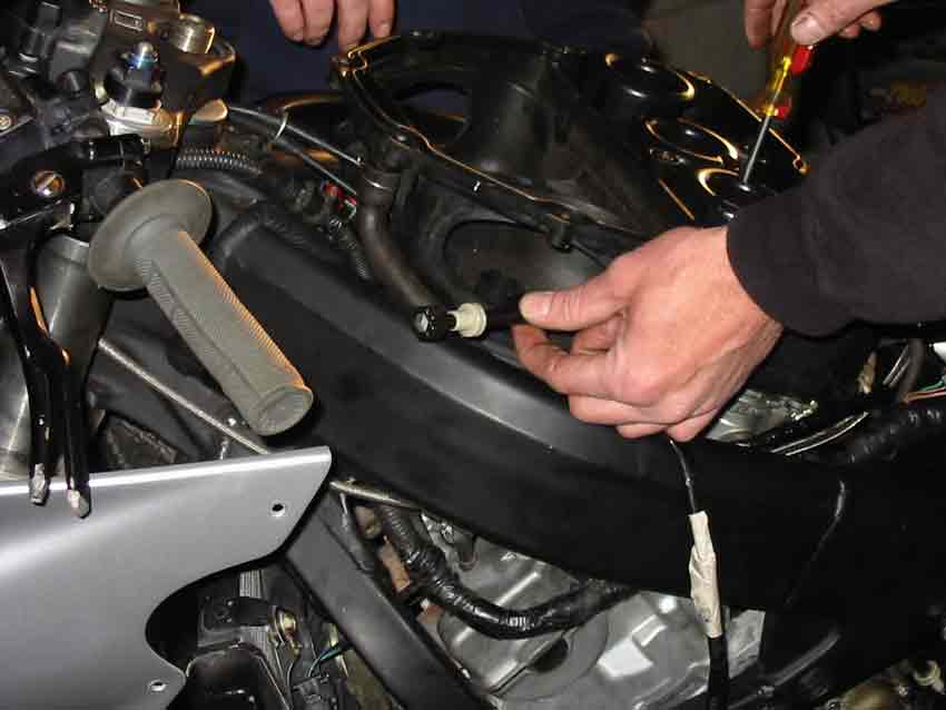

Here are a couple of pics. Very simple thing to do. You should leave the stock idle cable in place.

In the second picture I am pointing to where I put My new cable. You have to back out the stock set screw and simple screw in the replacment. I recomend you have the spring and washer that comes with the 900 cable.

It is the 900rr cable right? i put one on my bike but it wasnt long enough to come out by the neck of my bike. I had to run it down and out the side by my radiator.

Not sure what year it is but one of the years is longer then the other. I put a 96 900 RR cable and you can see in the pics where it came out.

You can get the idle to the desired RPM and only have to twist the cable like 1/4 to 1/2 A Turn and the idle is more sufficant then when you use the stock Idle up. This is for the f4i's. I am sure the f4's are fine stock. The stock setup doens't even open the throttel bodies it only fatten's up the idle simalar to a choke.

This is important! The stock 'idle' adjuster is not really idle, it is a fuel flap adjustment. It will only allow you to 'adjust' a little higher than stock. You MUST leave the stock on attached or the bike will not run. Just add a new f4i adjuster from the dealer ($35 or so) and you are good to go...it will reach to the right side of the tank near the neck.
