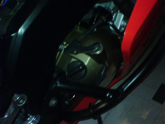

my clutch is quite stiff , i have the raptor ez pull. but i know its not the lever , the lever is great. i found my clutch stiff last year. i tried lubing the cable but didnt seem to work. any way i can adjust it or do i just need a new cable ?

new cables are cheap if it's your cable
do the clutch release lever mod you just want to make the top part of the clutch release lever longer
cut the clutch release lever in half, half way between where the cable hooks up and where it is welded to the part that goes in your motor
then add 3/4 of an inch to it and it will be so much easier to pull
this pic is dark so turn up your brightness on your monitor
Name:	clutch lever.jpg

okay ill do that. Im learnin my slow wheelies now so like after an hour my hand is actually sore .. ive never had that happen to me on any other bike and im after riding a load of bikes. its wierd.

yea my 636 was the hardest clutch i ever had till i did this mod

yeah my clutch dont seem warn out at all so ill do this . see what happens. Cheers old man
