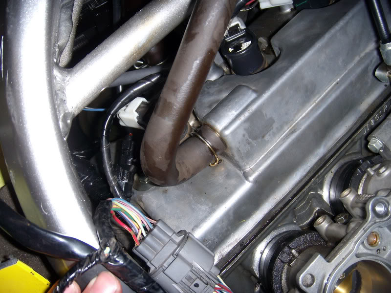

ok this is for the f4i guys. i did the mod but there was some confusion so with the help of farley i got it right. and i took pics!!:YEAH
ok so remove air box you will see this
this is the pair valve as it sits on the bike
this is the valve taken out.

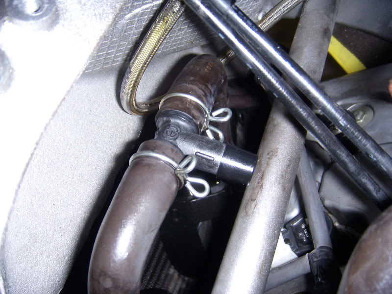

you can take it apart and remove the insides or just rplace it with a plastic T fitting like so..
after replaceing this valve you will not need to use this hose.
now you can take the pcv hose that comes outta the left side(clutch side) of the valve cover and hook it to theopen end of the T

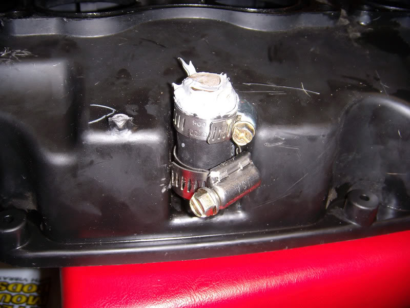

your done with that now you need to plug the two holes in the air box you can do it how ever you want i used a bolt, hose, and silicone. here are the pics.
this is a good mod i got lucky cause i didn't break anything when i hydro locked so i suggest you do this cause it might save your motor!!
