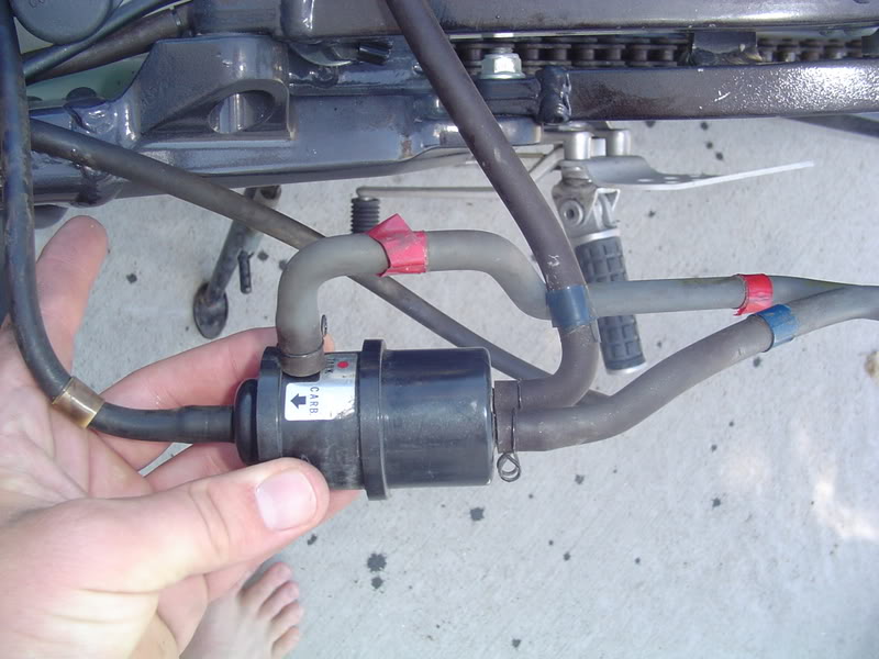

i did mine today i had the cali model. is it ok to just leave the stock part in like in my pic

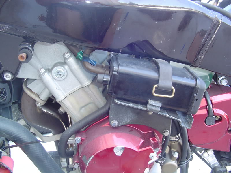

heres all the cali emissions **** i pulled out
Old Aug 19, 2007 | 07:50 PM
  #319
Re: kleen air on my 636-good idea!
yes it is ok too use the stock t as long as you plugged the vaccum line that goes to it
