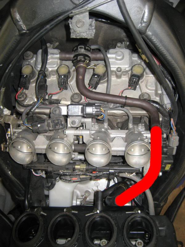

ok i know i have to join these 2 hoses

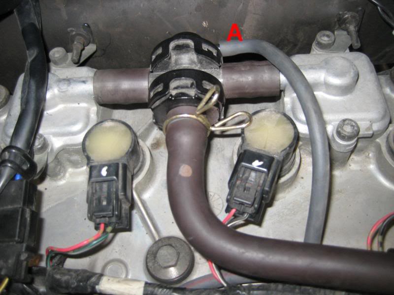

But whats the deal with this T piece can use the standard one and still run the vacume line to the sensor or do i have to block hose (A) off? if so WHY? what does hose (A) do?

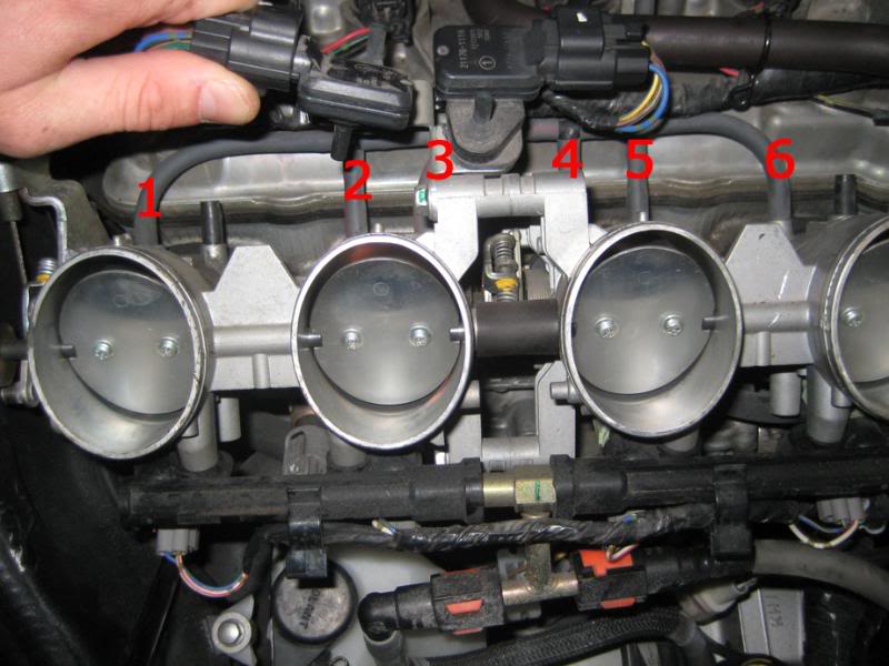

Or do i have to take off all the vacume lines and cap them all at the throttle bodies.

just take off hose A and stick a screw in it , it operates the pair valve but when you unplug it then the valve just stays open and acts just like a t fitting...
and dont forget to plug the holes left in your airbox
