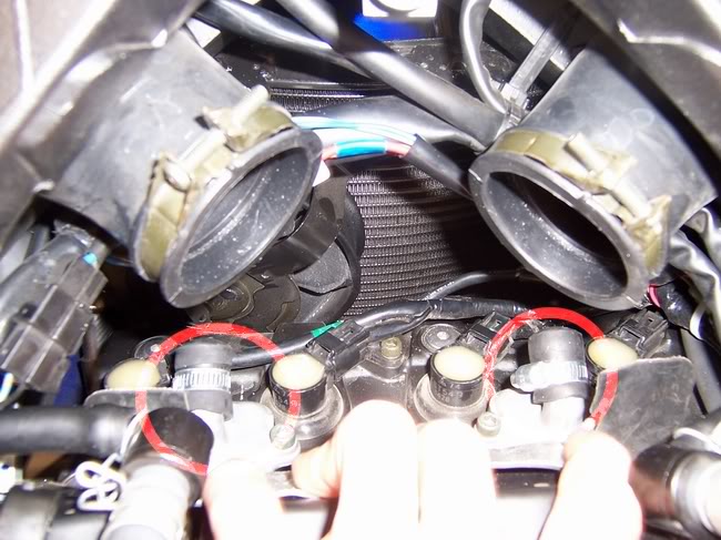

ok soooooooooooooooooooooooooo,
all i have to do is join these two ports together with hose, and get a T so the crankcase vent hose is in the middle, and whaa laa its the same as the 636 ****?
and plug certain spots of the airbox aswell of course

**** i forgot to add this pic to go with my last post
Old Mar 21, 2007 | 09:44 PM
  #172
Re: kleen air on my 636-good idea!
well i have never done one on an r6 but that looks like the way to go ..
did you cap off those two ports ? i used the stock t on mine but it looks like yours is gone so just buy a t fitting and put it in between those 2 ports and run another hose to the crank case breather port
but just make sure they do get ported thru the exhaust like on the 636
that pic isn't my bike no, i got it off an r6 forum on a topic of how to disconnect the air induction system
there isn't a T on it stock nope, cuz the ports are facing to the front, not to erach other
