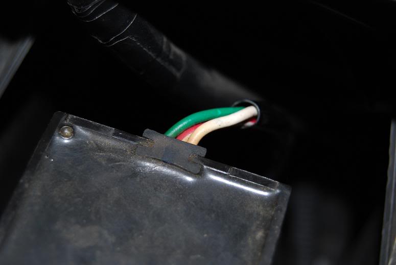

Theres 3 wires to the tip over sensor.
Cut all three, take off that dam thing. and connect the outer two wires. leave the middle wire hang.
can simply use elec tape. its the first thing i do to my f4i's
this wont effect the bike at all

Just cut the red and green wire and splice them toghter. You can find your tip over sensor hooked on the top of your f4i Lights. So Cap off the white and tie the red and green toghter.

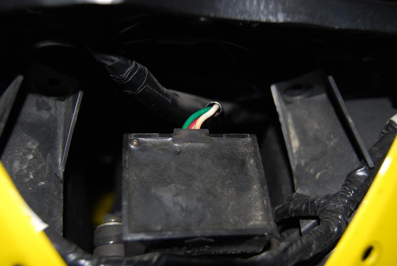

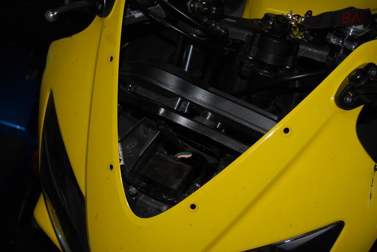

So cut all 3 wires, connect the red and green together, leave the white hanging??
dont know if i should do this mod yet.. just learning basic wheelies right now.. what you guys think?

[QUOTE=j-flights;3165597]So cut all 3 wires, connect the red and green together, leave the white hanging??
ITS EASY AS HELL TO DO. IDK WHY ALL THESE PEOPLE ARE ALL WORRIED ABOUT DOING IT. JUST GUT THE THREE WIRES, TAPE OFF THE WHITE AND FUCKEN SPLICE THE RED AND GREEN... EASY! DAMN

I was wondering if you had to cut and splice the wires at the sensor and not from the connector?
it dont matter i just did mine the other day and now i see why everyone says its easy, everyones overthinking it....

Originally Posted by AzN~BoI_585
He did it all professional...i stuck a horse shoe shaped piece of wire in the plug and wrapped it in electrical tape
thats exactly how i did it !!!!
