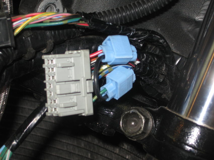

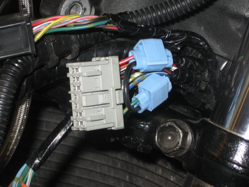

Old Jul 22, 2007 | 02:35 PM
  #77
larson's Avatar
Joined: May 2007
Posts: 251
From: St. Cloud, MN
larson is a decent person
Re: F4i Tip Over Sensor Help
Never Mind I figured it out.
If you ride with the gauge cluster then you have to cut it at the tip over sensor and connect the red and green together.
But if you ride with no gauge cluster (no front harness) then you have to connect the wires together at the front grey harness or otherwise the bike wont start. When you turn the key there will be nothing.
here are some pics of the way I did it at the front grey harness because I ride without the gauges.
