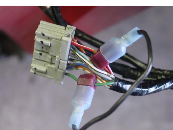

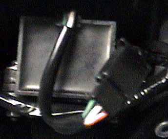

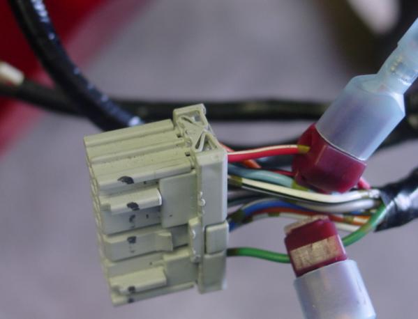

here ya go, I've posted this a bunch of times...just jump those wires that way and you're golden...

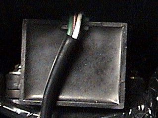

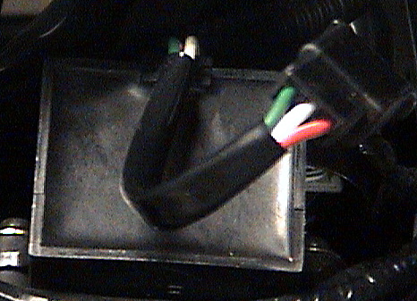

ok is this the tip over sensor( SEE PIC )? If so I just cut all wires and tie red and green together and leave white taped off? This won't affect the running of this bike at all if I do cut wires?

^^^someone help me out so I can put this thing back together? ^^^^^^
Old Feb 17, 2006 | 08:45 AM
3824's Avatar
Posts: 37,827
Re: F4i Tip Over Sensor Help
just like instructions say cut green and red and tie them together.
cool thanks Scott just making sure that was the right box. It doesn't look like the same plug as atnuts posted. thats why i was confussed
