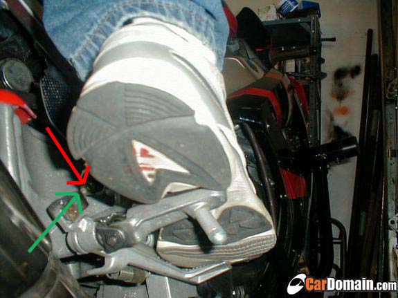

ok ever one says to cover the rear brake when practicing wheelies. i used to ride a gixxer 600 and all was swell. i recently got a 954 and the lever is much higher.when i do sit down wheelies, because of the angle, i physically cannot cover it. i looked in the booklet and is doesnt say anything about adjustment? anyone help me?

no seriously guys, i have my foot on the peg, then to apply pressure to the brake i have to take my heal off the peg and press down with my toe on the lever, thanks jay, maybe ill stop by some time later this week. . . looks like its gonna rain now

but in all seriousness. the red arrow is the adjuster nut, the green arrow is the lock nut to keep everything in the same spot. you cant really see it cause of the angle of the pic, but its there. loosen up the lock nut, and turn the adjuster nut. one way will bring the pedal up, the other down. just look out for your break light switch. too much one way or the other and itll either stay on, or be really hard to turn on with the rear brake. the switch can be adjusted basically the same way, but its behind the lower fairing and kinda hard to see.

oh yea and dont forget to tighten the lock nut back down to the black bracket, the one attached to the brake leaver.

its not that im short or have small feet, its just that the lever is so damn high and i have to have my foot pointed up as far as it can go to get it on there, even when i do its hard to give light pressure.
but thats for the help. ill try and adjust it.

it's exactly the same. every bike i've delt with has the exact same way of adjusting the rear brake play. there is a bolt, going to the master cylinder, with a nut on it, and it's adjustable.
