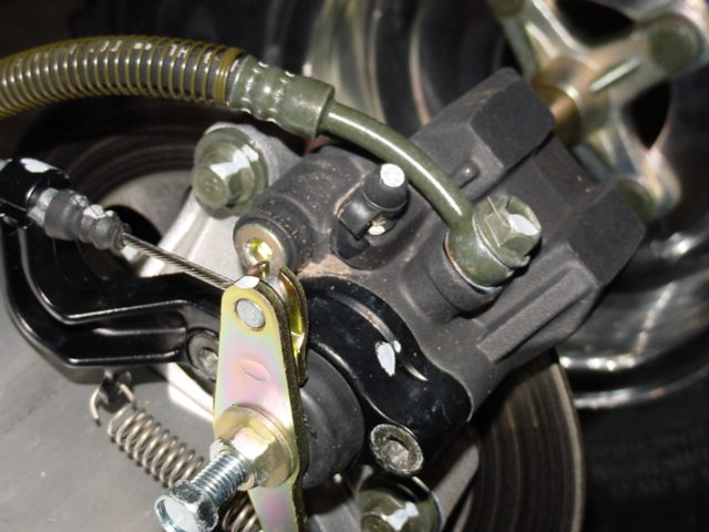

Here is a quick over view. My quad has a parking brake that is ran by a cable from the caliper to my clutch lever. When you set the brake w/ the lever a spring holds it. If you take the cable off the clutch lever - and attatch it to a different lever & perch, you now have a cable activated rear brake. Just attatch a spring on the caliper so that it snaps back. So simple it is scary.

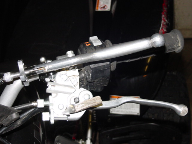

Here is a pic w/ the lever in the 1st position. I have it under the clutch lever now so it is easier to reach.
Pic 1

pic 2 w/ flash on.

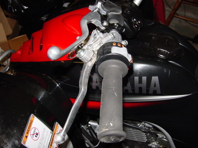

pic 3

looks good for now but you need to figure out how to use a smaller lever . im sure it works awesome but it looks bulky as hell

oh yeah, that lever is only temp. I have to get a Decompression lever that I can use like 1 finger on. That is my clutch lever off my quad zilla , i needed something and stores arn't open today. Once i get a small lever, its on.
I want to move it to the right side (throttle side) so i can do some one handed tank wheelies. HELL YEAH! 12 oclock tank wheelies are mine.
-god.
