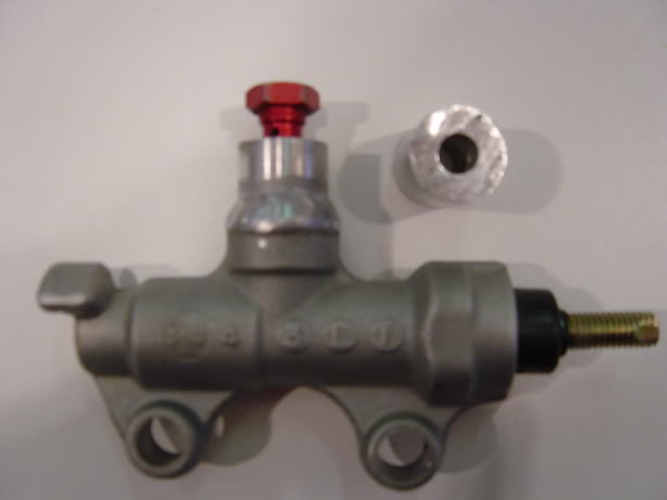

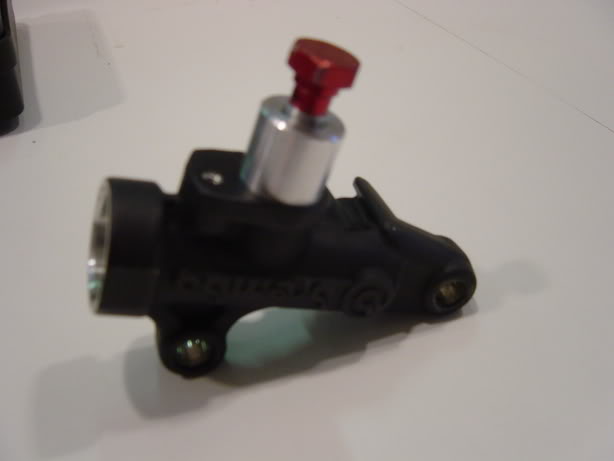

This is why from the start I made my own adapters for $2, and TIG weld them onto the master cylinder...They will never leak, and then you can focus on bleeding...Then if theres a problem its not the adaptor....

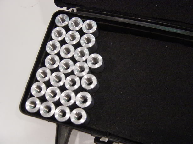

thats the only way I would trust one of those , I had one hoseclamped and smashed the brake hard once and poped the o-ring. got it welded but ended up getting a DC right after.

Originally Posted by Alpha Chino
didnt i sell you an adapter?
the ones i make are machined with such tight tolerances, no JB weld or clamps are necessary.
