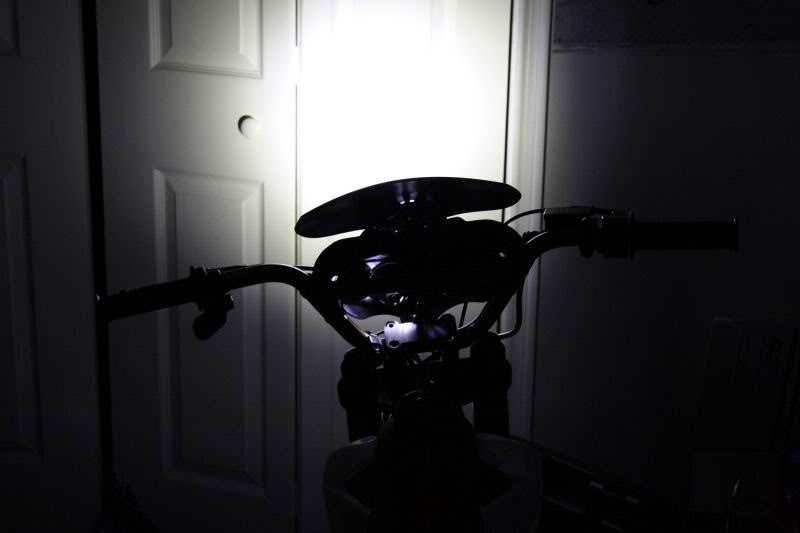

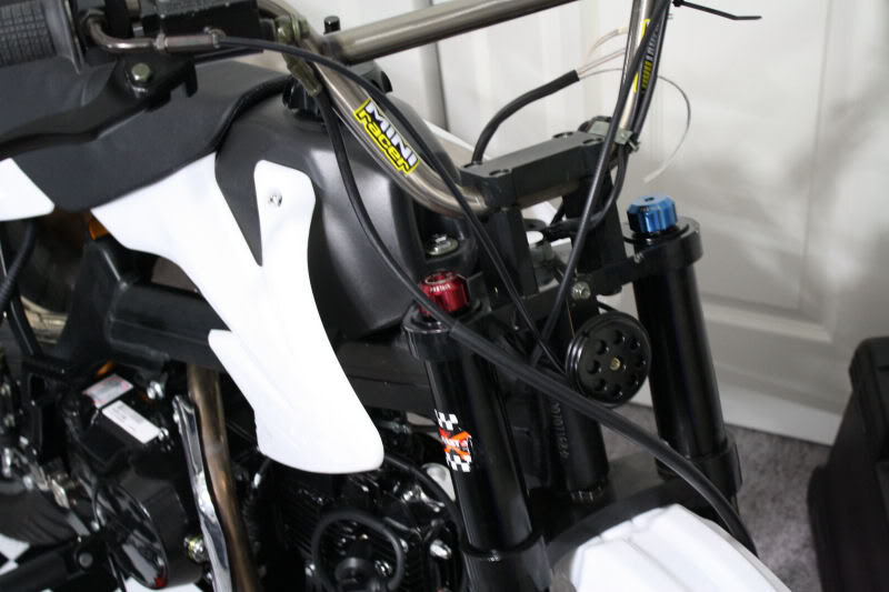

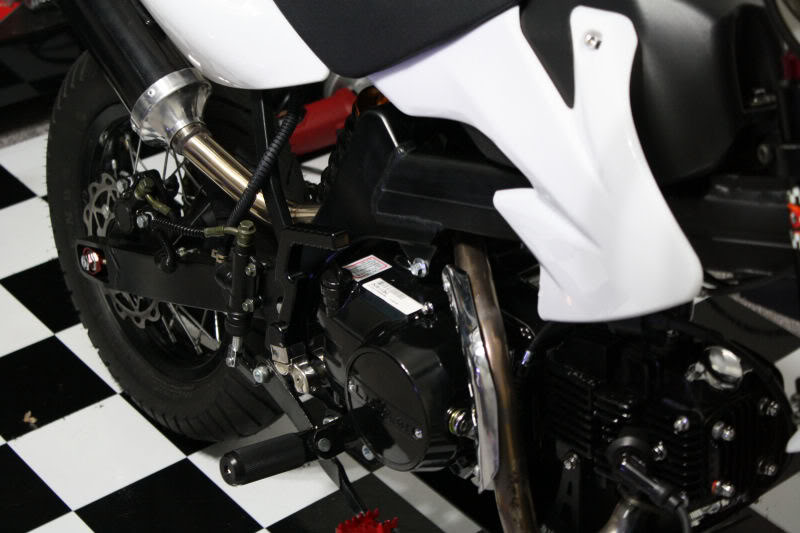

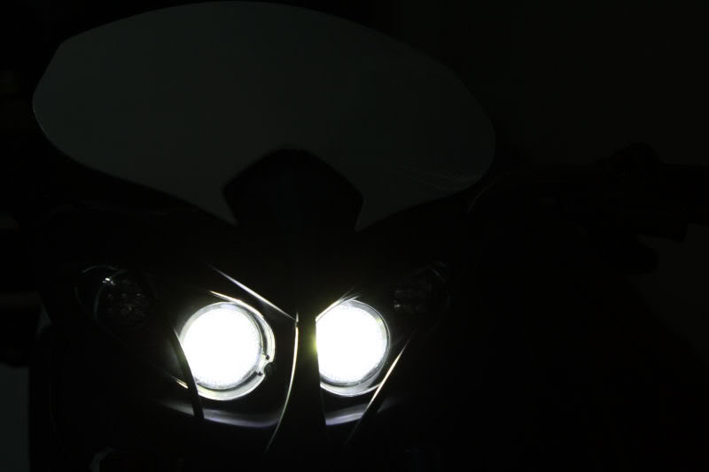

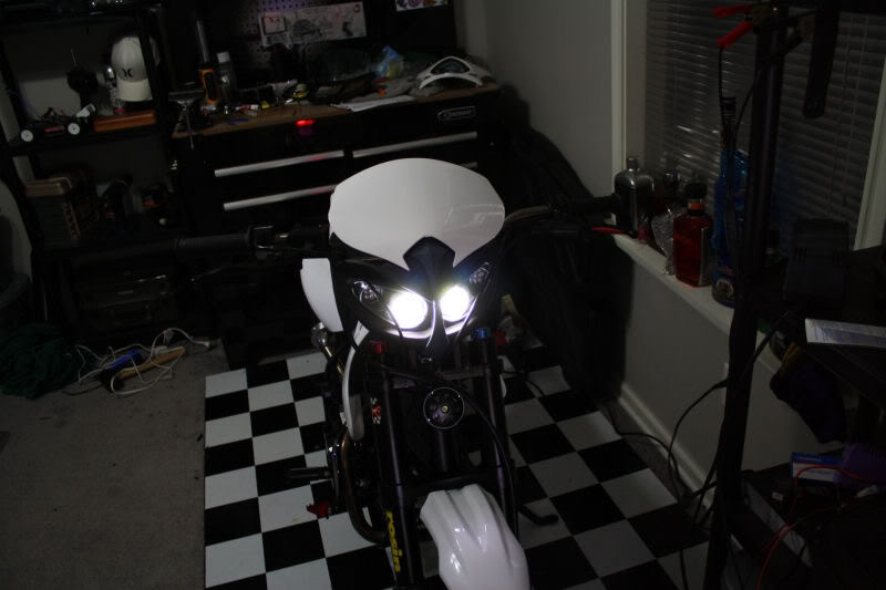

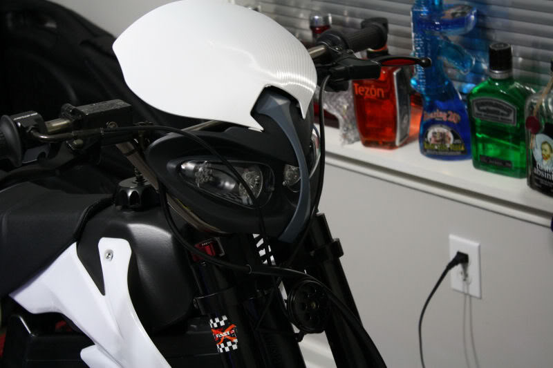

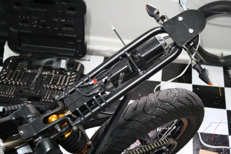

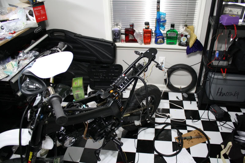

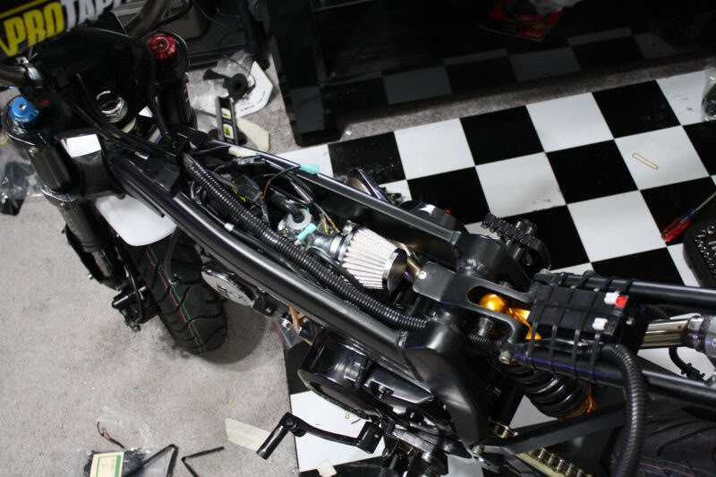

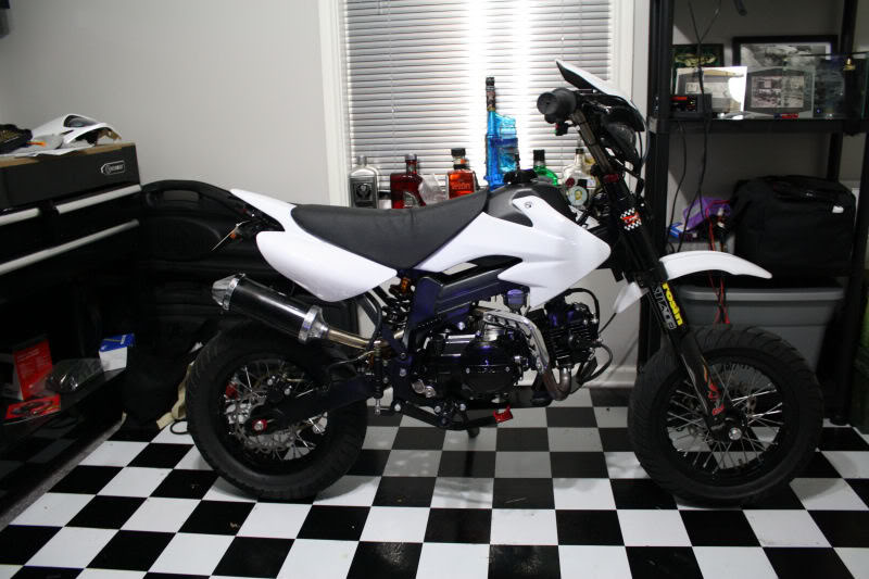

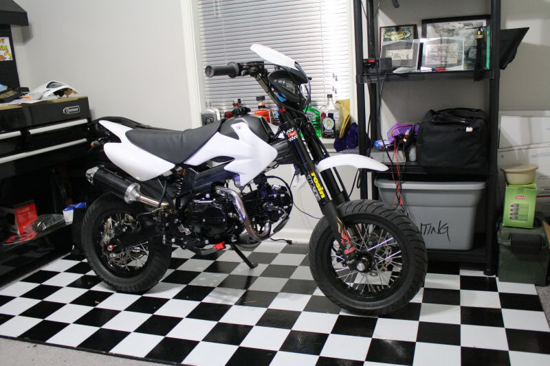

Just added a third bike to the stable... 125cc Lifan, twin spar frame, 12" wheels, FastAce Suspension, 16/40 gearing and LED street legal lighting. Still need to tune it but it's a blast on the streets. I'm not sure what it tops out at yet, but just riding around yesterday I went 53mph according to the GPS.

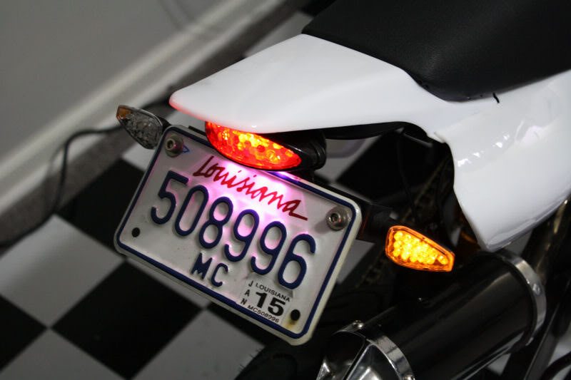

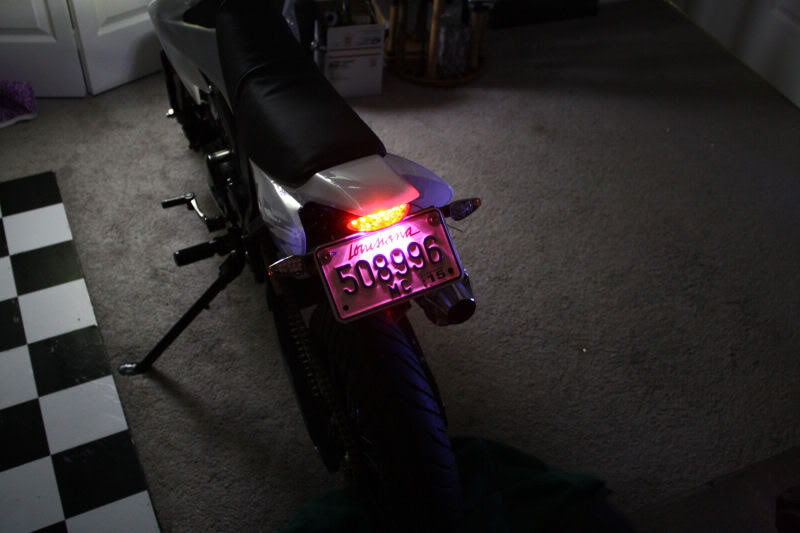

Got my new plate in yesterday
Old May 23, 2011 | 11:14 PM
jimG's Avatar
Jim G
Joined: Oct 2008
Posts: 481
From: mass
jimG is a decent person
Re: My Street Legal Stunter

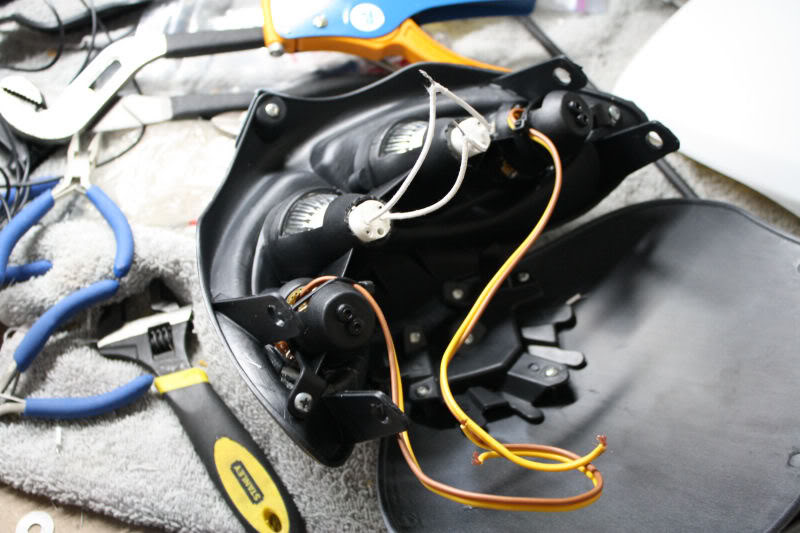

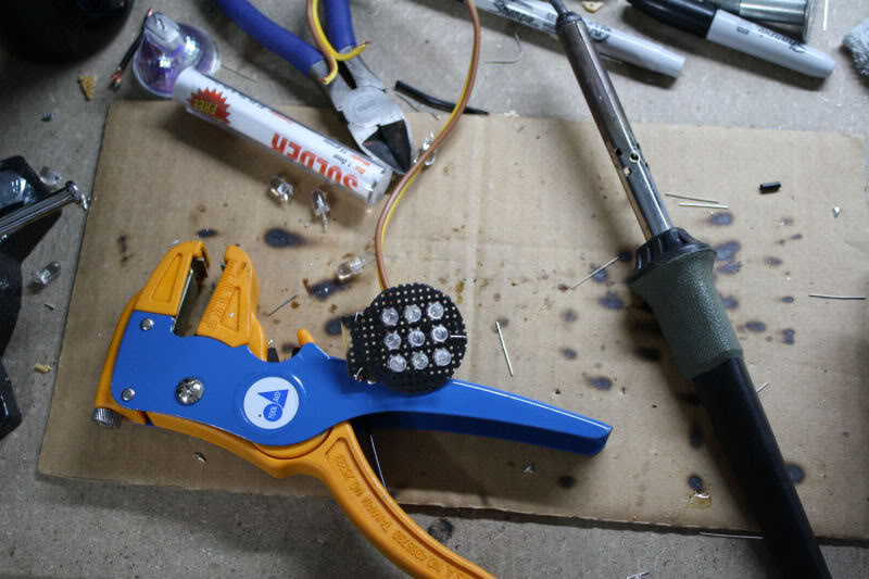

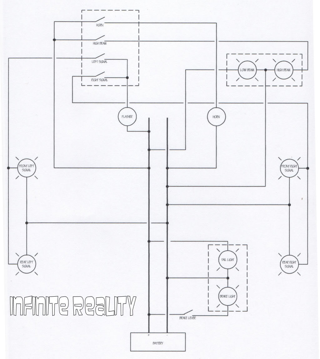

can u explain a little on how u wired this?i kinda understand u used a chargeable battery and a bunch of leds,but how do u get them to blink and how did u get the brake to light when used??
Old May 24, 2011 | 08:09 AM
InfiniteReality's Avatar
Joined: Mar 2009
Posts: 239
From: Lake Charles, LA
InfiniteReality is a decent person

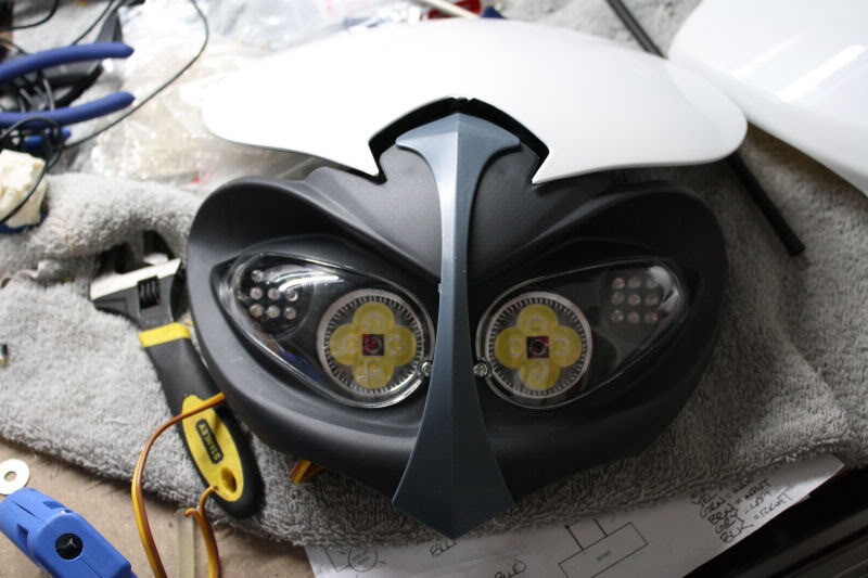

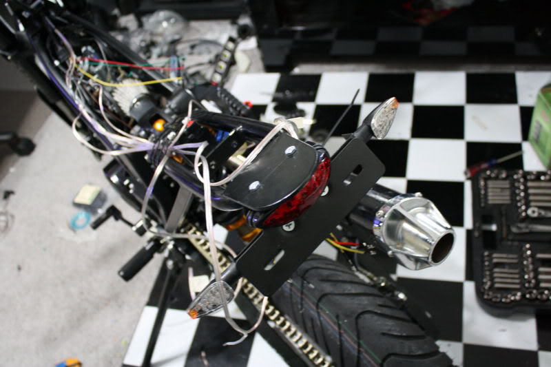

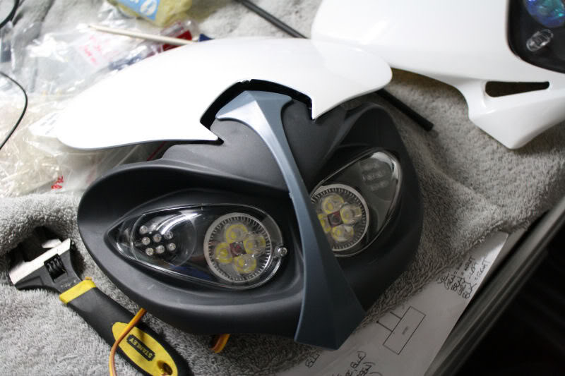

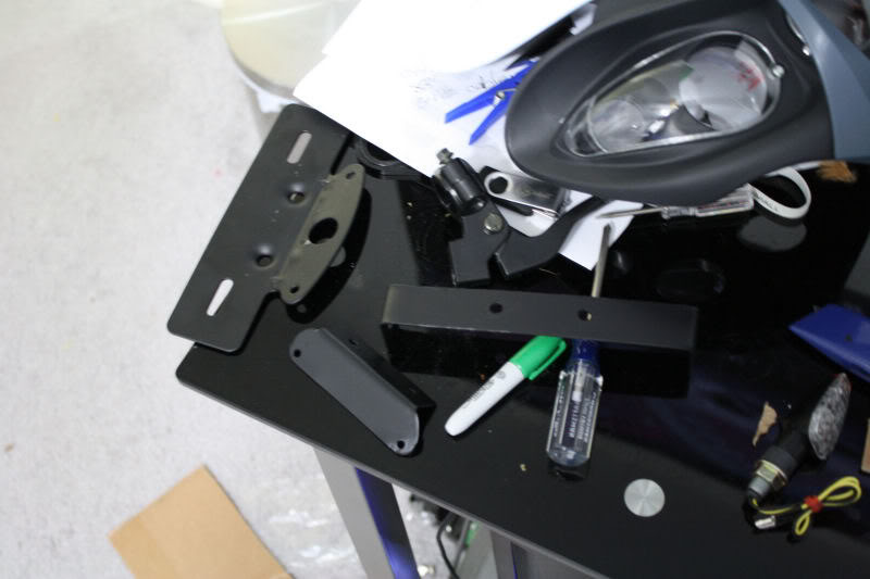

Wiring wasn't bad, just a little time consuming with soldering all points. If I think about it when I get home, I'll post a schematic I drew up before I started it all. I actually re-used it when i wired up the minimoto 125cc.
Yep everything had LEDs from blinkers to headlights to brake lights. There is no need to make your own LED brake light like I did, I just wanted something that fit under the tail. As you can see on the minimoto I bought that one, looks MUCH nicer and even had a plate bracket on it too. For the flashers, I used this:
http://www.superbrightleds.com/cgi-b...LFS-1-PIN.html
Works perfect for almost zero current draw of them. You just hook one side up to positive and the other side to the input side of the signal switch. the output of the switch goes to left or right blinkers. For the brake light, I just got a scooter brake lever. There are tons of options on how to do this, I chose to use my rear hand brake lever to activate the brake light. I wish now I'd used the front brake lever since that's where most of the stopping power is but I had no clue I'd ride the bike this much on the road. I actually have a front brake lever, just need to swap it out. I also have a foot brake switch which I never installed, got it from bajadesigns. I also got my horn from Bajadesigns too.
Hope that helps some!

For some reason I'm have issues exporting my schematic from CAD so I printed it out and scanned it in. Hope it helps.
