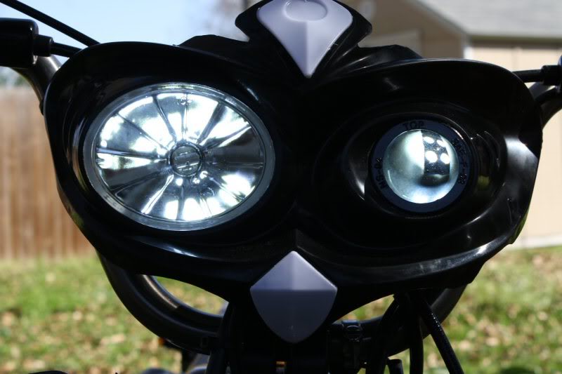

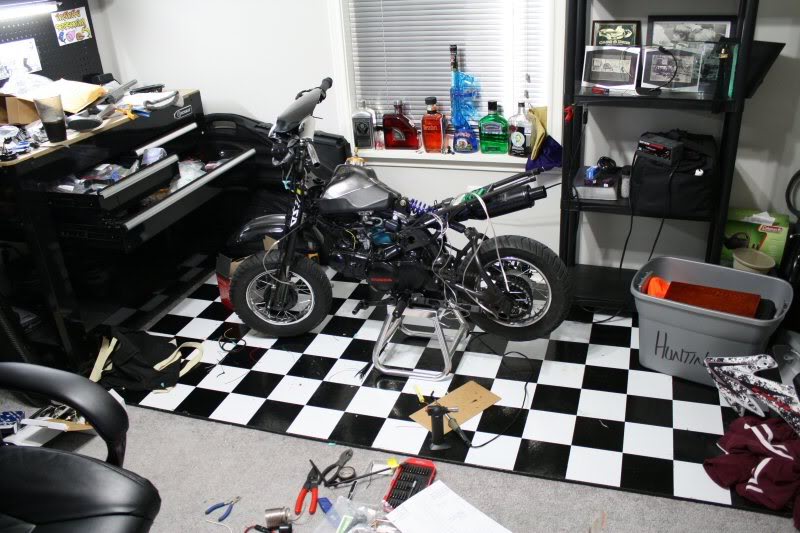

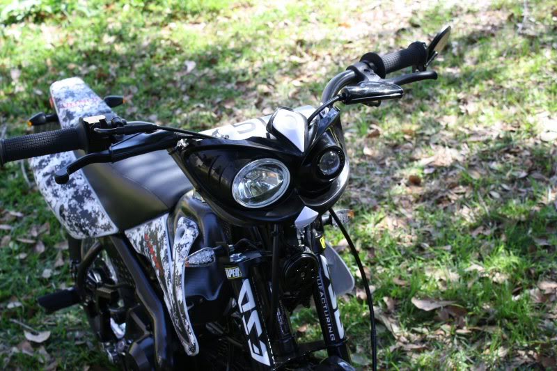

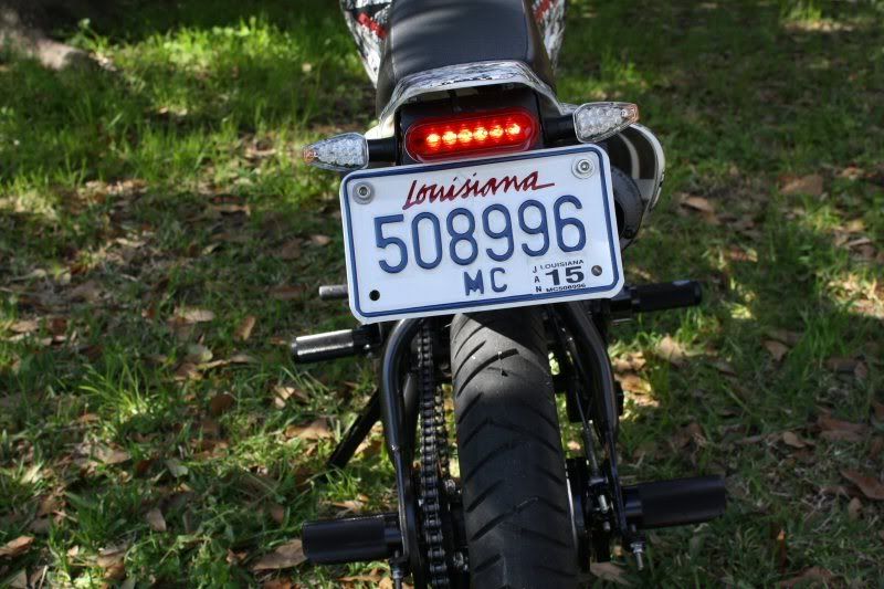

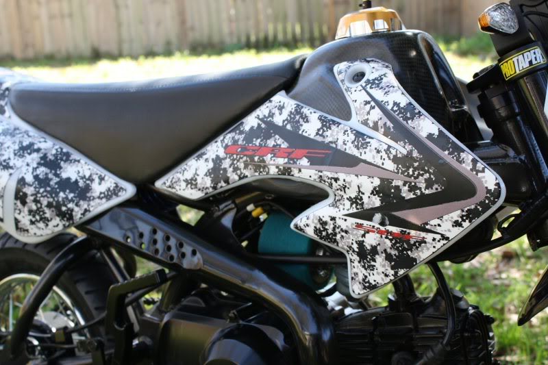

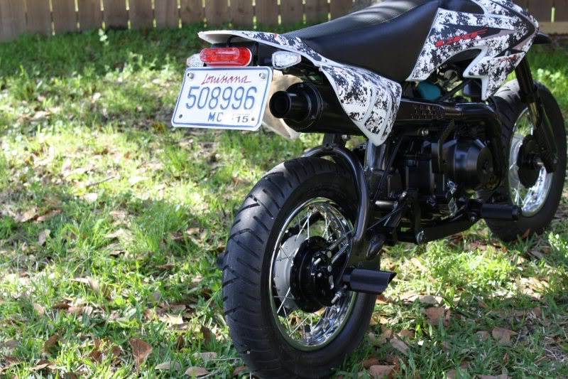

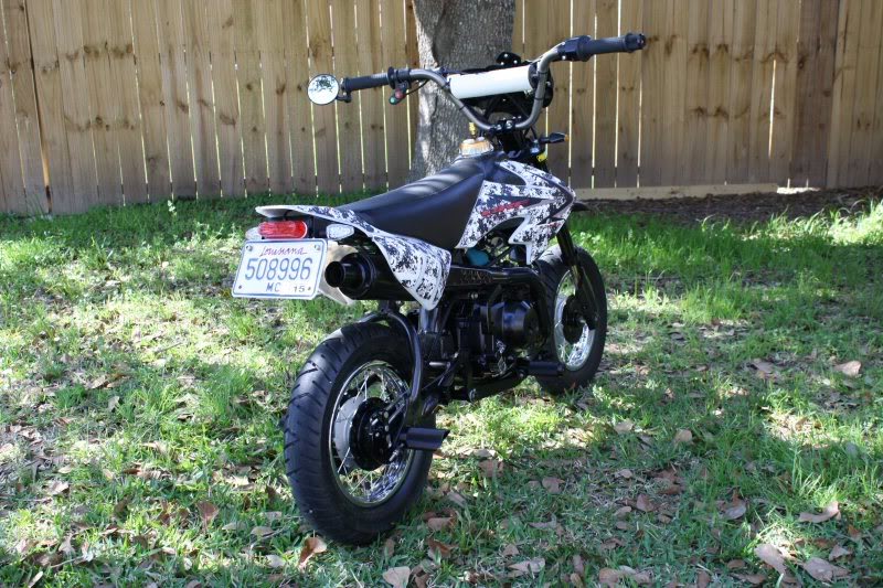

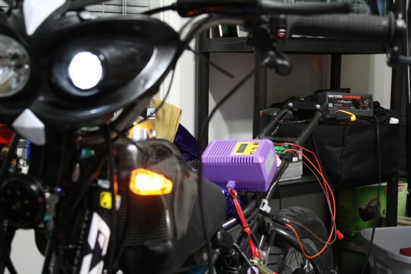

My Street Legal Stunter

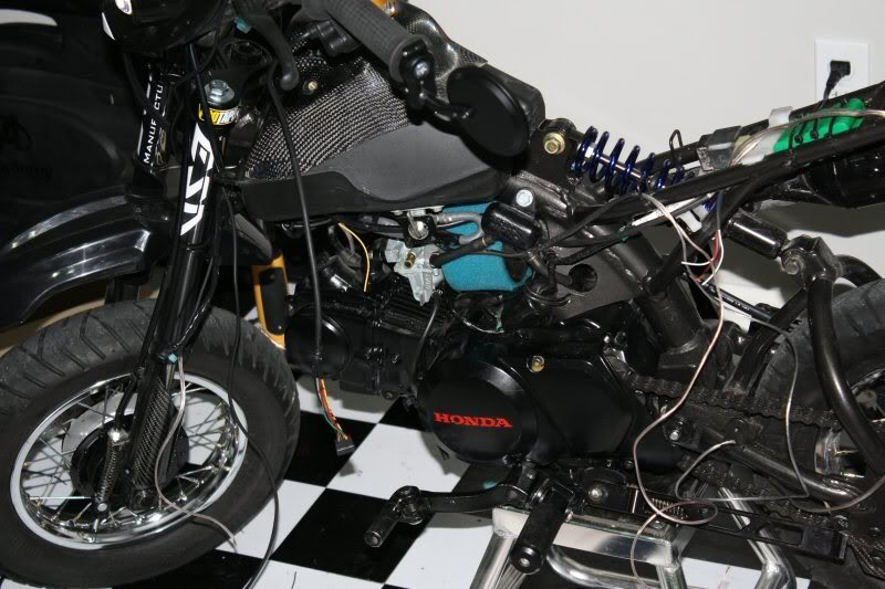

Decided 6 months ago I was going to make my 50 street legal and did a lot of research to find out exactly what I have to do physically as well as the paperwork. I bought it about a year and a half ago from a co-workers 10 year old son. Took it from there and made it stuntable as well as some graphics I designed and cutout.
To make it legal here in Louisiana I had to wire it all from scratch. I was going to go the stator route, but instead chose the battery since I planned on running all LEDs, even in the headlights. I bought a small 12VDC 2200mA battery from an online battery store that would fit between the rails in the tail. Zip ties may seem cheesy to mount it with, but I guarantee it won't go anywhere. For brakes I got a scooter left hand brake, but it ended up being made of plastic. It works and I installed it but just ordered both left/right 7/8" black metal ones with the switches for brakes and they're on their way. The taillight is off a trailer I believe, I just took the guts out and made a board with 6 red 10mm 60000mcd LEDs and wired it for running light and brake light. The signals ended up being the most headache and I haven't found a solution other than to use resistors to make the flasher work. I've tried 1/2 dozen electric flashers and none of them can work with such a small load on the battery. I'll have to look online and I'm sure I can find one.
The part to get it legal was a lot easier than I thought. After it was all wired, brought it up to the State Police with the ORV title & drivers license and let them do an "Affidavit of Physical Inspection" which really only amounted to reading the VIN off to the trooper and talking to him about it, he even wants to do one and took my name/number down, lol. Next was I had go to the DMV with my title, paperwork from the State Police, proof of insurance ($2.40/month BTW), driver's license with endorsement and $70.50. Got me a plate on the spot with new legal registration. Came home, put on the plate and hauled *** (as much as a 50 can) to an inspection station, did all the lighting tests and got my inspection sticker. Now I just wait for a cop to pull me over, he can't do a thing!
Since I already have my registration, just ordered a personal plate for it. Really had no clue what I could put so simply stuck with FIDDY. I have till Monday if I can think of something better, but FIDDY is reserved for me.

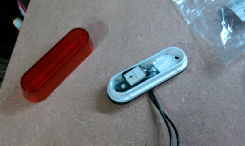

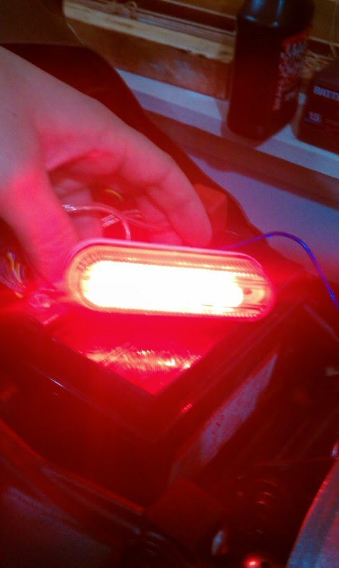

I'll see what I come up with. Trying to buy another 50 to street legal and sell. If I can do that, I can duplicate the wiring harness and make up a couple of "kits" that'll be plug & play. I've put about 50 miles on my bike so far and love it... Never would have guessed it'd been so much fun on the street, especially knowing a cop can't do a damn thing.
I had to take mine by state police to inspect it and sign off on a form. To get that form you have to have your title and registration though. Luckily I had both since previous owner kept his... selling price on the title was to the sweet tune of $420, lol.
On a side note, I made mine 100% legal even up to the yellow reflectors on the side of the signals (IE, like side reflectors that come on new bikes). Also kept the stock exhaust on it. Basically didn't give them a reason they could actually fail my bike. Even though I did it 100% by the book, was still worried they'd find "something" that I'd have to change... nada, passed with flying colors.

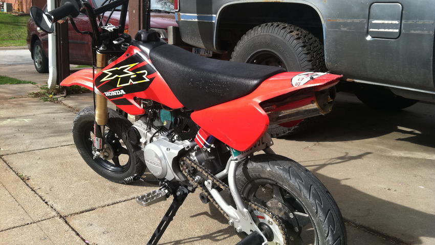

A buddy of mine got one of these rolling chassis and Lifan engine and put it together. After I did mine, he got in the mood to do his though with all the lighting and street tires, but it'll be a little more headache since no title and have to do something called a red bike (or similar). It got me thinking though.... Since mine is already plated, I'm seriously contemplating getting similar setup and just say **** it and rock the plate on it if I want to ride it on the streets with it. Adding a 3rd bike is never a bad idea and I'd like to keep the 50 how it is for stunting.
