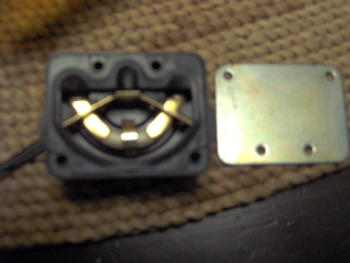

Old Oct 26, 2006 | 05:31 PM
  #130
Catman's Avatar
Posts: 1,788
From: Da Nati
Re: Gsxr Help Page-
Is dis my Tip over sensor ???
If it is ,and is mounted right ; it only moves side to side not back and forth
sorry 2000 gsxr 750 and it was mounted in the same place as the one in the pic, looks a little diff, but i guess i see how it works but still only looks like side to side

Old Oct 29, 2006 | 06:09 PM
  #131
LOWS10's Avatar
Posts: 139
From: Calgary
LOWS10 is an unknown quantity at this point
Re: Gsxr Help Page-
IT is your TO sensor but in a high wheelie i could possibly wiggle around and move to one side causing the bike to shut off. Dissable it. I got the same advise.
Glue that b*tch right in the midddle where it's at in the middle. problem solved!
