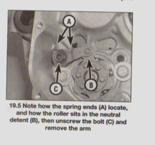

Re: F4i shifting problems
the problem is the detent arm, and gear selector drum or " shift star". the stock one is a piece of crap.
factory racing makes a way better detent arm kit and shift star.
i have this kit on my bike and it work flawlessly. shifts are way faster and it never pops out of gear. both kits are about $200 bucks but well worth it.
