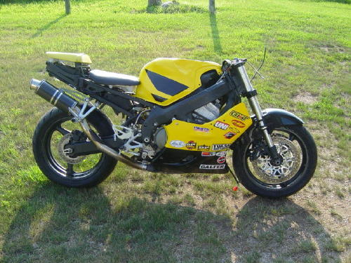

its getting closer to being done..... waiting on a bunch of parts yet....
Name:	ebay2 108 (2).jpg

yo brotha i got an f4i in similar condition. wut did u do exactly for the 929 954 setup
theres some forks off ebay for good deals im tryin to act on
any help appreciated

i got 954/929 forks, upper and lower triples, front rotors and front fender..
u can use the f4i wheel, but you have to machine some spacers and bushings..
id recommend just getting the 929/954 front wheel and axle...
as far as good deals go......... just keep looking and asking......
ebay has em, but they go for a pretty good price......... good luck..
