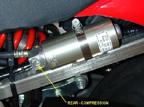

Adjust the preset sag on the suspension.
My F4 sits 2 1/2 inches higher than most F4i's. My guess is because I messed with the sag and everyone else didnt.

Re: rear is too low
Wrong pic... ^^^^
Here is the adjustment you can move to raise/lower the bikes tail. If you have your tool kit, use the "C" lookin one to adjust. If not, get a hammer and a screw driver.
