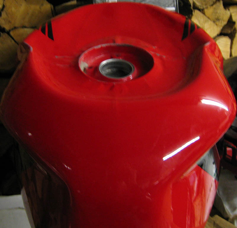

Your 929 tank may be a little different.... I just did my 954 and it went pretty well.
Use a dead-blow hammer (rubber/poly coated w/ buck shot or sand inside it). First work around the cap and move around in circles out to the edges. You'll probably break the cap, like I did... but a vortex fixed the problem.
Careful of creases, they can turn into cracks. I got a few crinkles here and there but nothing major.
Take your time and work it.
I pushed the filler hole all the way down to the bottom of the tank... just enough space to fit a gas pump.

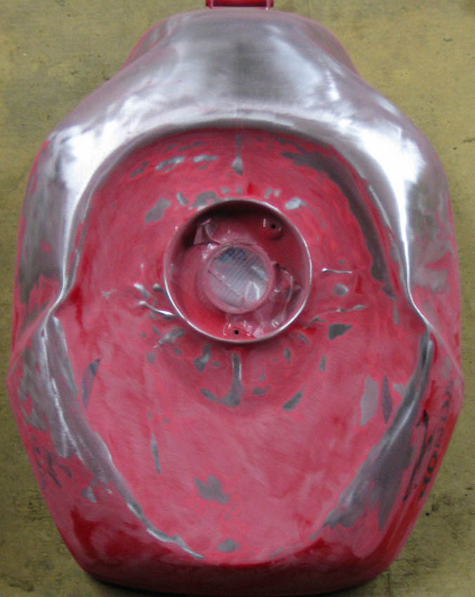

Lots of bondo and sanding for a flush cap.
Like I said, my filler hole is ALL the way down to the inside bottom of the tank, it WILL NOT go down any further.
The cap area was a kunt, but the rest was tit.
Just leave the cap in it so it dosen't get really deformed. Use the stomp method 1st on the cap to get it down, then finish up w/ a dead-blow.
I'm strippin mine down this wkend and fillin the whole thing out w/ bondo, then repainting. Gonna lose alot of the depth to the dish but it'll be nice comfy and smooth, w/ a good back rest.
I'll post up results.

Started to strip tonight....
