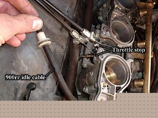

stock idle can only be adjusted till 2300 otherwise it will jump all over the place..., i have just put a F2 idle cable on the throttle stop between throttle body 2 & 3, see pic below (they used a 900rr cable but it think the F2 one is longer), and now you can put the idle a little higher but you will have to find the sweet idle spot by adjusting the stock & 2nd cable...

File Type: jpg

I can agree with Loco-Honda, the stock idle on my 954 just goes to 2000rpm and jumps up and down so I only turn it to 1800, I will do the 2nd cable mod soon and I will also use an F2/F3 cable cause they´re the longest.
