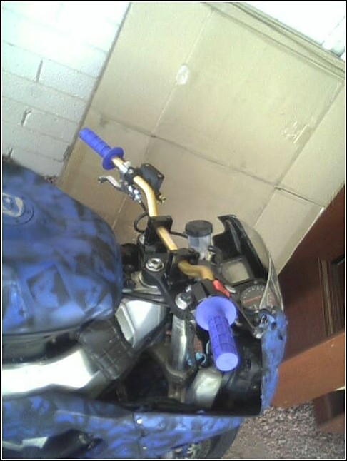

I have the DB clamps for the DB bars for a 929 . I got them from Freestyle Ingenuity about 2 weeks ago and decide to go with FI 0 degree clipons. The clamps are specially fabricated from the 929 triple. I got the setup for $165 and will sell it for $100 plus $15 to ship. Comes with Scary Gary Renthal Bars. Here is a pic of them on my 929.

U have several options.
1. Freestyle Ing..... Risers - Very Good - But a little too high and some what difficult to mount.... and stabilizers have to be changed, Scotts/GPR don't work and Ohlins has to be reversed and raised 3/4 in. I've done 2 sets for friends and one for a team member!
2. Fly Racing has a universal mount that sits on top of the triple, easy to mount, not the strongest but this is the set up I have for now and it works great for the past 9 mths through several good crashes. I also had to reverse the ohlins stabilizer and rais it almost 1 inch but it works great.
3. Get a RC51 Top Triple and TAG risers (Easiest set up) but finding an rc51 top triple is hard....
4. Find someone w/ a machine shop or CNC and they can machine/mill a similar to stock w/ 1" thick alumium and make a top triple very strong and any set up will work!
- I have one being made right now!
