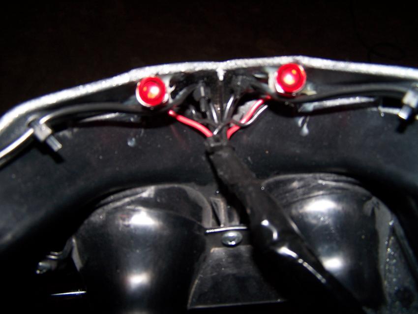

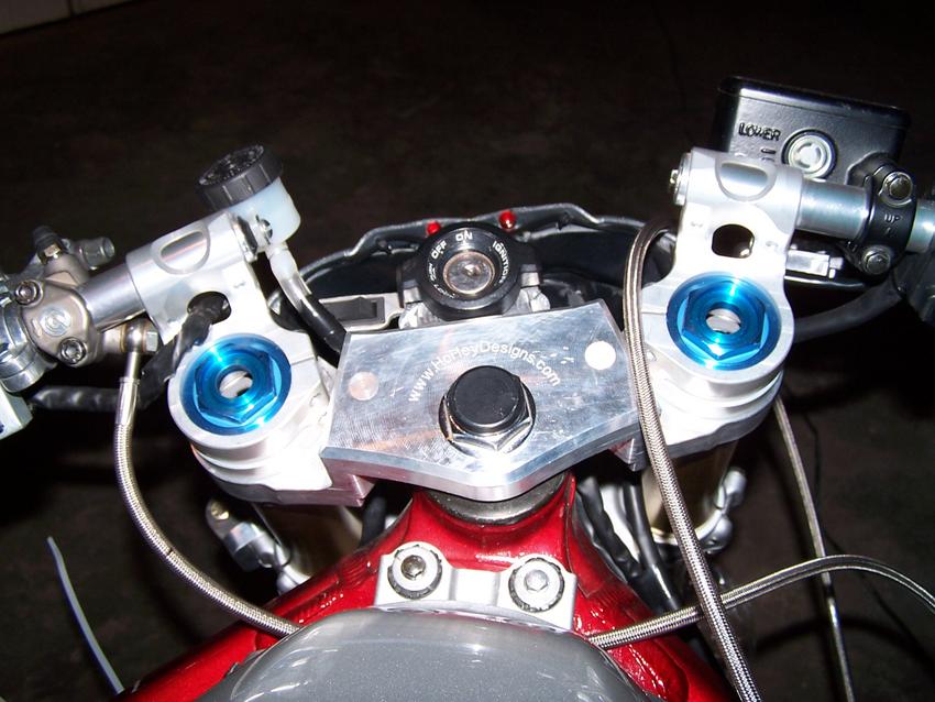

i've heard a lot of complaints about not havin a gas light(low fuel) after removing your gauge. even some that have run out of gas and crashed, maybe even gotten hurt.
so i was thinking of a way i could have some gauge light and came up with this.
its just 2 small leds i bought at radio shack. all you have to do is find the harness that the gauges plug into and use a red scotchlock to plug into whichever wire you want(i have one on "low fuel" and the other on "fi light"(to diagnose problems)) and the other wire(from the led) to any ground.
after that just epoxy the leds to the inside of the headlight and let dry overnight. your done! it would probly take the average person about 10min. no more runnin outa gas
for those without a wire diagram, i have one for the f4i and 600rr so just pm me and i'll let ya know what color wire you gotta tap into for the light you want. ie. gas, oil, fi, etc.
