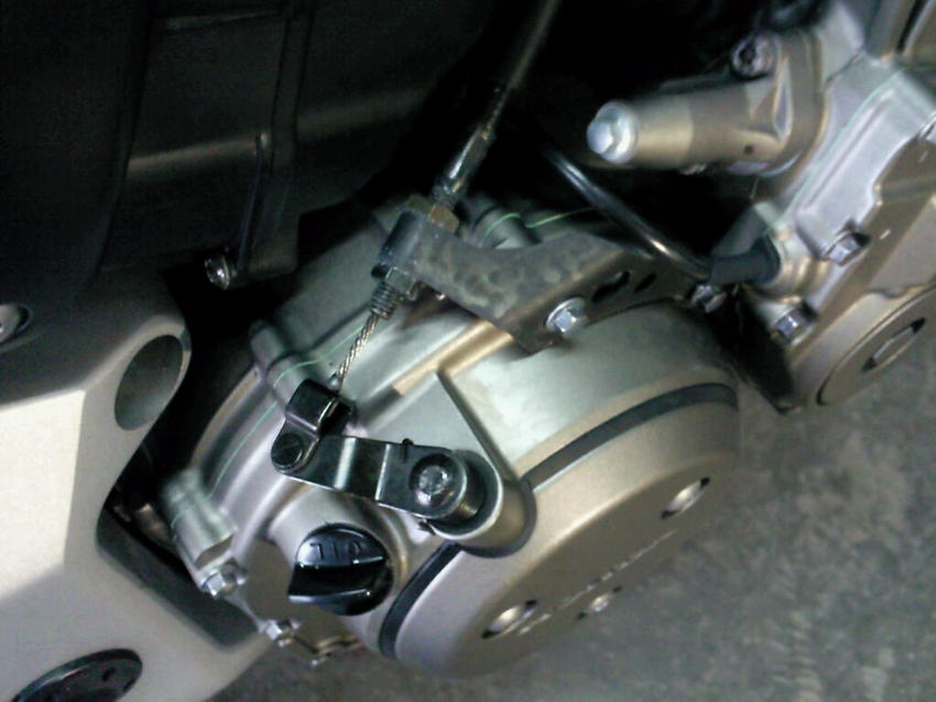

Originally Posted by kj
So... I can't weld and my guy lives a lil far to haul my engine down to him while i have it apart... so I figured out a way to do it the ghetto way.
Grind out the rivet that holds the swivel/cable connector on the end of the stock arm and drill one more hole about half way down the arm.
Get a piece of flat steel and cut it to size... I did about 5/8 - 3/4 extra length...
Mark and drill out the two matching holes to bolt up to the arm... then a 3rd hole on the end for the cable connector.
I used 6mm grade 12.9 bolts and made the holes just a tad small so the bolts actually screwed them selves into the arm... the nut on the bottom is just for safe measure.
That's how my boy did his and it works just fine...don't sweat it!

This is the welded version on my 919 I decided to do it today just testing out my new welding hood.
ID:	219850   Click image for larger version
