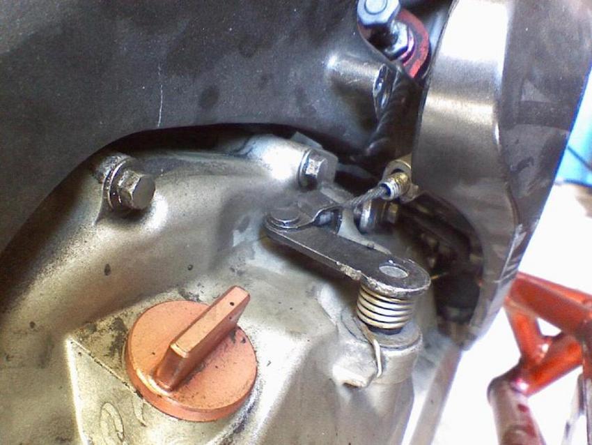

as for that ezpull mod. I'll see if I can get a pic of the motor and you see if you think you could find a way to do it. I would nut my pants if I could have the same clutch pull on my RR.......I wouldn't do anything but coasters and endoes just cause I could pull in the clutch like I want.

i have an 06 rr motor here and i think i remember thinking if i made the clutch release lever go up at an angle and changed the angle of the cable holder that it would work or just raised the whole lever up and moved the cable holder up...either way it would take some fabricating so if your good at that you can make it work

just make your clutch release lever 3/4 of an inch longer and you will have a permenant easy pull that will never break....
you mean by adding on to that arm where teh clutch cable connects?

yupper
lemme ask you this.....say you make the lever arm angle up which makes it 3/4" longer, but the total lateral distance is around 1/4"....is it still gonna make enough difference like it did on the F4i, or would I be better off pissing into the wind?
I posted a pic in another thread about changing tires, but I'll post it here too.
