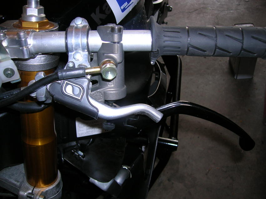

msr ,raptor series easypull..

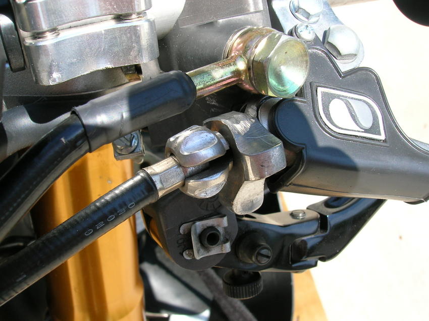

DONT GRIND THE MASTER,CUT TWO OF THE EARS OFF THE CLUTCH ADJUSTER AND YOUR GOLDEN..

I HAD THE CLUTCH ON THE INSIDE BUT WANTED MORE LEAVERAGE ON THE HAND BREAK,THATS WHY I CUT THE EARS OFF AND MOVED IT TO THE OUTSIDE.
HERE`S BEFORE & AFTER..

Looks like your bars are aftermarket too? I have the switched, turned, and flipped clips still, and you got hella room on yours it looks like, talk about leverage...
Old May 27, 2007 | 01:29 PM
PAINTRIXX's Avatar
Joined: Feb 2007
Posts: 722
From: stanley,N.C.,UNINTED STATES
PAINTRIXX is a decent person
Re: 636 easy pull clutch
Vortex Clipons,but Everything Is Slid As Far In As Possible,thats Why The Space Between The Levers & The Grip Looks So Big..
