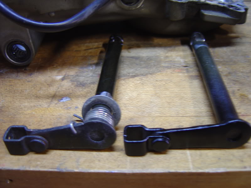

it's not a good pic but if it cut trough this part at the top of the pic then yes i think im right about this one

Re: Anyone ever break clutch rod?
ya it just broke a chunk off of it ont he side of the factory cut hole for the pin. Your conclusion makes sense for sure
notice the two clutch release levers in this pic , one is longer then the other....
that is the clutch lever mod that makes your bike have an easy pull that will never brake, this one is only a little longer then stock but mine is about 3/4 of an inch longer then stock and it is the only dependable way to have an easy pull clutch

Old Mar 24, 2007 | 11:56 PM
E-Loc540's Avatar
540 BOYZ SUMO STUNTER
Posts: 1,251
From: Fredericksburg, VA
E-Loc540 is an unknown quantity at this point
Yeah its all about leverage. When you have a longer arm you have more leverage on the linkage.....
