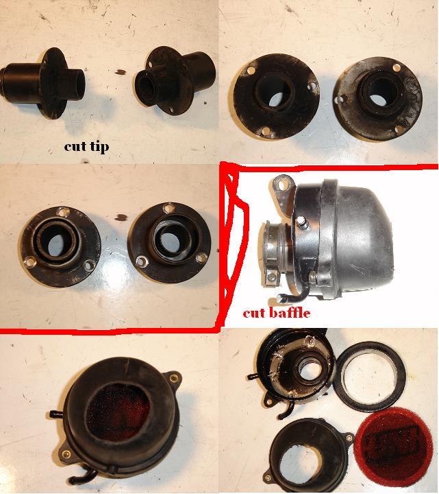

Old Jul 24, 2005 | 03:52 PM
monsterminibike's Avatar
Posts: 9
From: TN.
monsterminibike is an unknown quantity at this point
Re: air box mods?
Originally Posted by WAX-AZZ
what kind of mods should i do to my stock air box to make it best possible?
http://www.starboyz.com/vboard/showt...threadid=15712
StarBoyz Forums - bought crf 50
