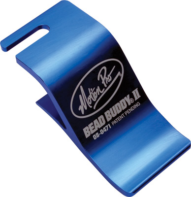

try using one of these to keep the bead in place and baby powder instead of soapy water, a very little bit of air pressure in the tube before putting on the second bead so the tire sits deep into the tire helps too.
i can get you one for 12.00 or so

ive seen them advertised never really knew how well they worked. or how

7mins into it youll see it used
http://www.youtube.com/watch?v=BE1qG9iQZlg
