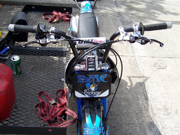

Respect, here are the pics of the lever set up.... Clutch is on top...
