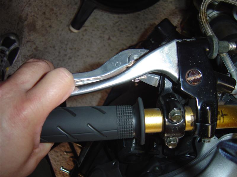

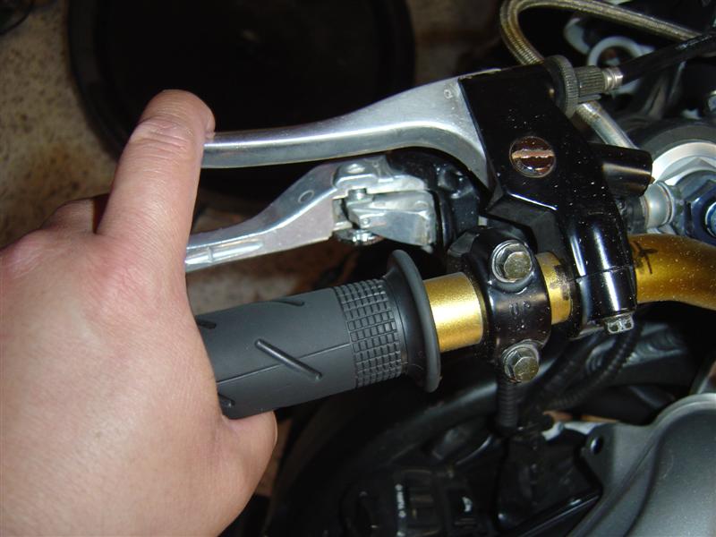

Well I went and added ¼” length to my clutch release lever and I’ll be testing it out tomorrow but as far as feel goes right now it’s definitely much easier to pull having done this mod. Honda F4i shown but I am sure it will work for any bike. Name:  DSC00059.jpg

In my opinion this mod already feels better than using a MSR Craptor clutch lever. Oh yeah the lever is up for sale! since I prefer using a stock clutch lever $35.00 shipped! Name:  DSC00002.jpg

**** looks factory are you running the clutch inside or hb inside... and is 1/4" the most you can go on an F4i? I'm about to do the same thing, but there's plenty of room on the 900... i'm thinking of going 1/2" or 3/4" ???

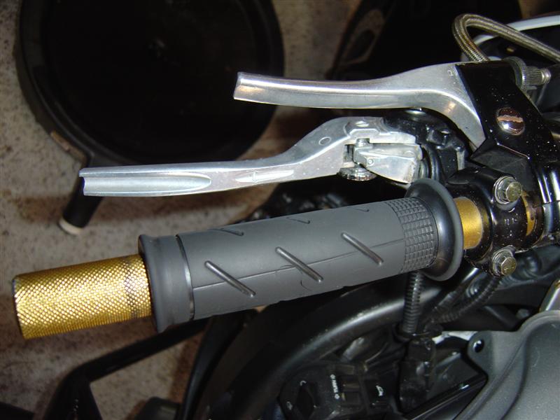

You can go 1/2" but I just went 1/4" I rode the bike today and the mod works great I can tell the difference but next time I will go 1/2" :YEAH
I need to move my grips out I have just havent got to it yet.

did you have to re-angle the clutch cable reciever? that bracket that bolts to the clutch cover and where you do the adjustments at? If I go 3/4" I think I might have to so it doesn't fray the cable??? should be easy enough with a torch and a vise though...
this is how mine is looking right now, not sure if I weant to keep it like this or go back to the stock clutch on the inside of the hb, how much difference the clutch arm mod makes is going to be the deciding factor...

i didn't have to bend mine ,it was far enough away so the angle was good but if you have too bend yours i would do it cold not with a torch

Cable looks fine going 1/4" it doesnt chafe at all but 1/2 you might have to re-angle the clutch cable reciever Can you move your clutch lever in more? Looks like you could get more leverage out from your lever
