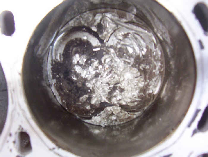

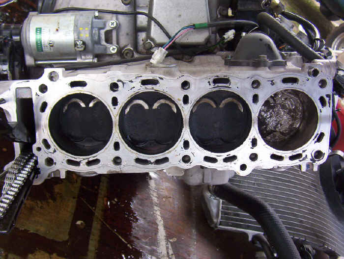

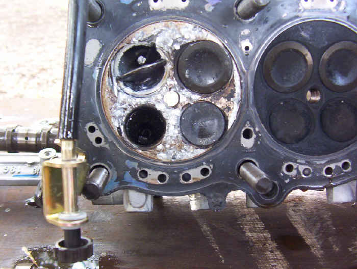

Well heres the damage, if anyone has a good head or valves I can get, or if anyone has the hookup on **** pm me, let me know...

you cant just put a head on that-you need a piston at least-may have a bent rod, etc-change the engine

HOLY ****IN COW where the hell is the exhaust valve!

damn mike!!! I was extremely surprised to hear that you might have spun a bearing since you installed the oil pickup. Glad that wasnt the case. But dropping a valve isnt much better. However, it is much easier / cheaper to fix than a spun bearing. You can get a new piston, wrist pin, head gasket and rings from ronayers.com and a head from ebay for around 500-600 bucks. When people blow engines from stunting, it is usually the bottom end that goes so heads are semi easy to find cheap.
Did you find out if the valve broke or if the keeper broke?
