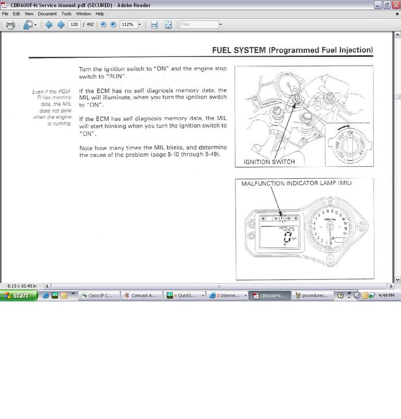

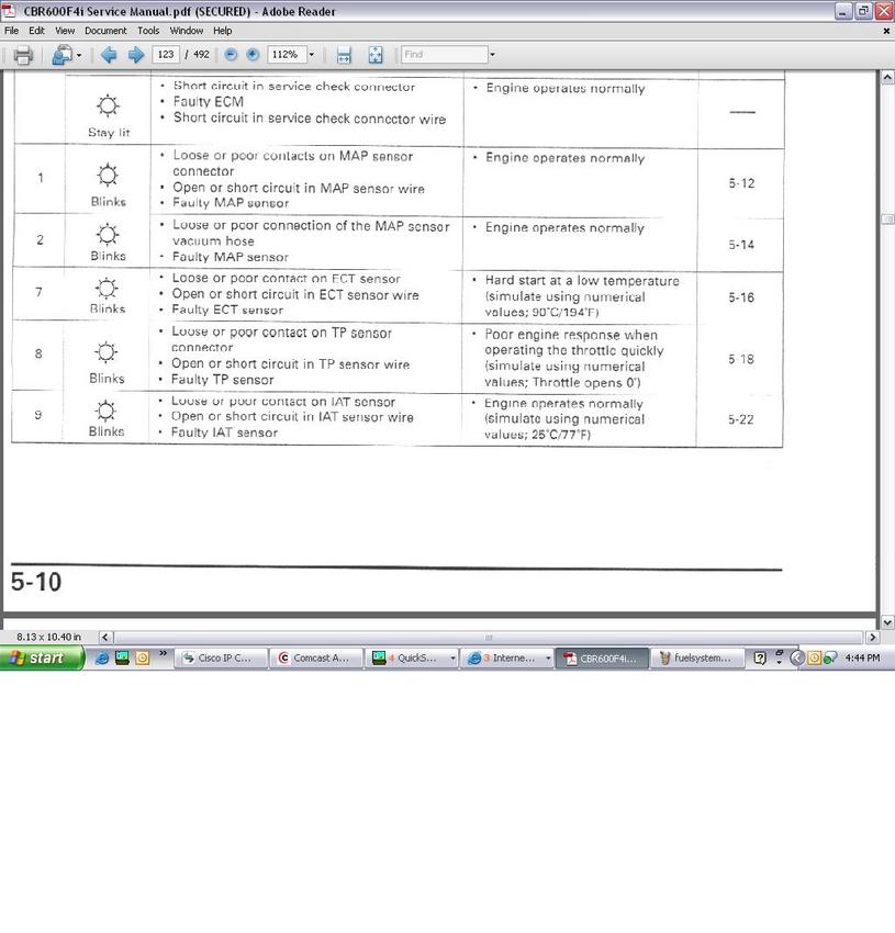

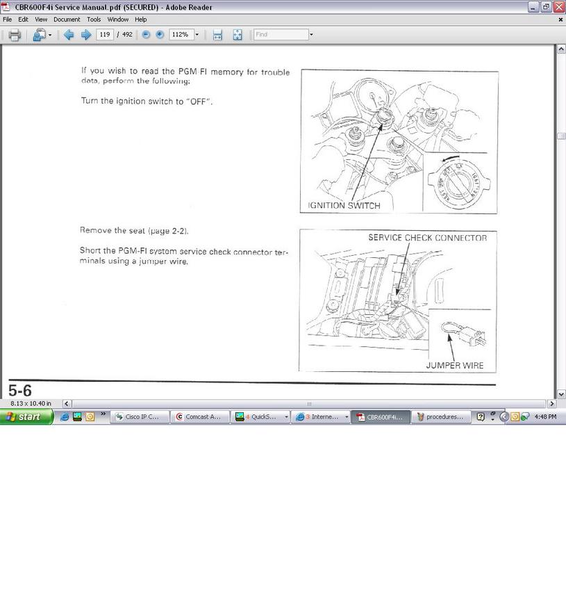

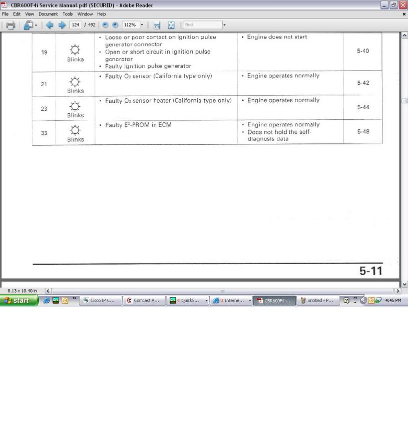

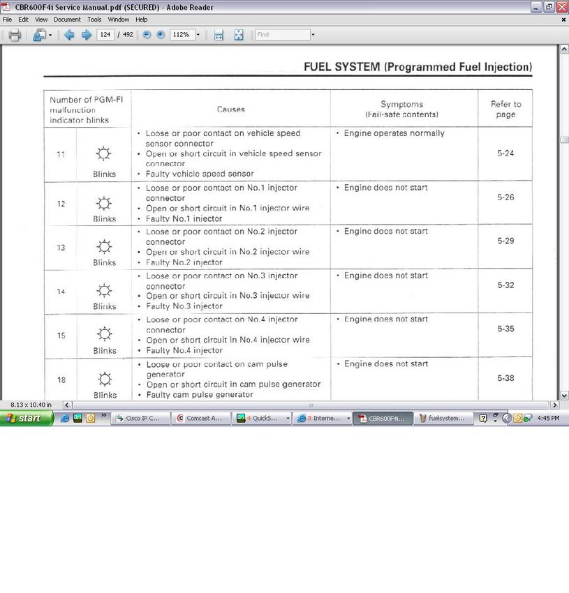

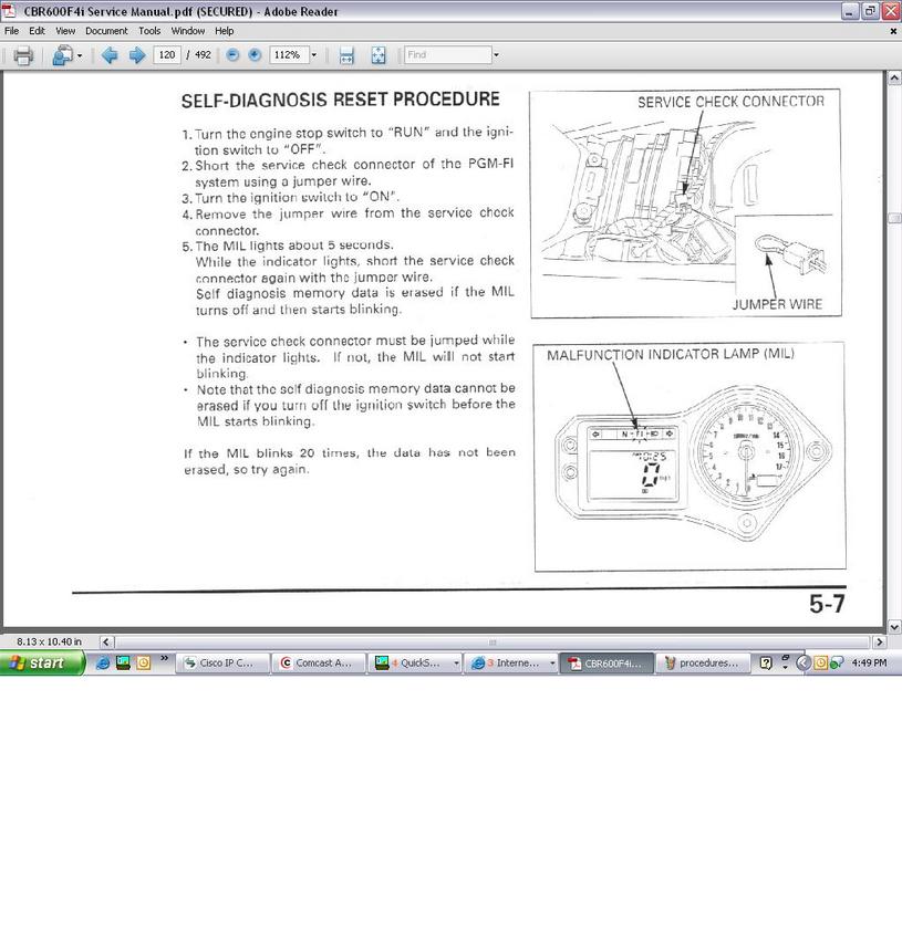

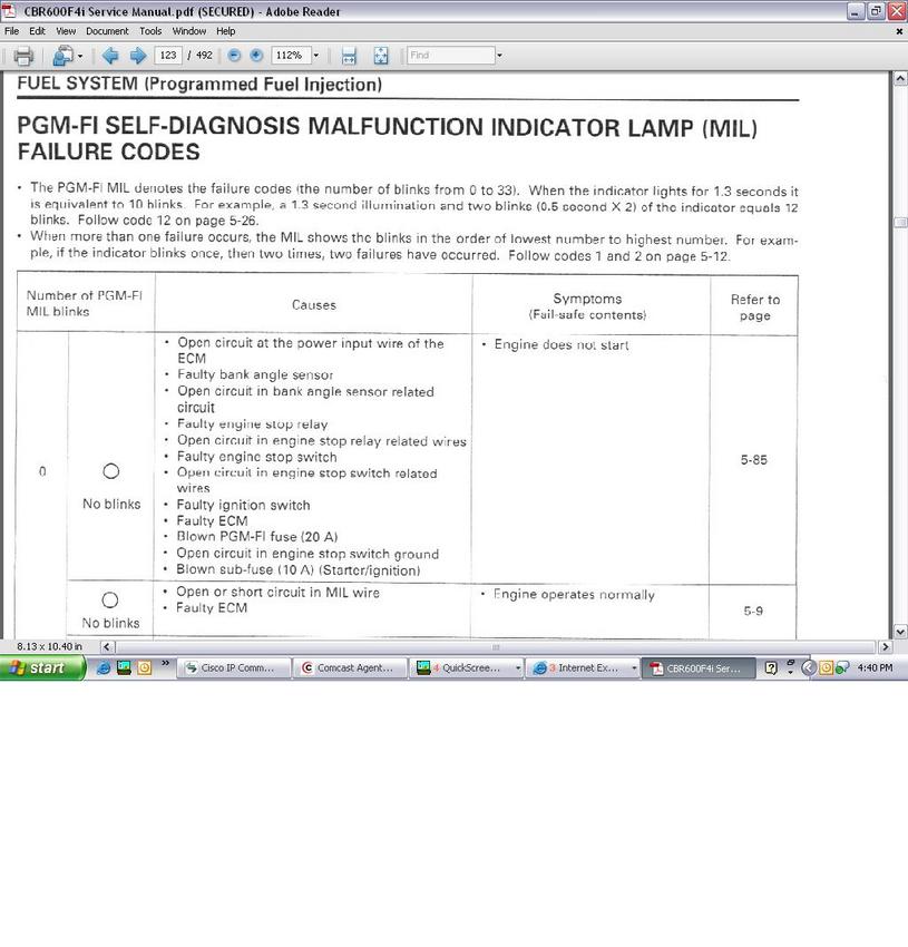

Take a look at these pictures for instructions on how to check the FI codes and a whole list of causes and symptoms. Hope this helps

very helpfull info right thur.... rep 4 you sir!..thank you

so looks like at some point someone changed the ect or just had to splice in a new plug but they used butt connectors and two of the three wires had come apart....i guess they couldnt hold up to me chuckin my bike on the ground all the time...lol a little soldering and cleared the codes....now no light..yay!! now hopefully it starts like its supposed to.... ill let ya know and thanks for the help nukkas!!!1
