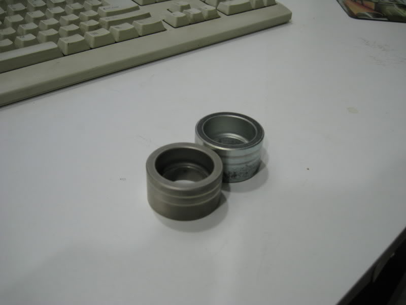

All the 03/04 spacers are made of steel, and the left side is a silver colour and the right side is a goldish/yellow colour....You can easily tell the differnce just by the weight and colour of them
All the 05/06 spacers are aluminum and anodized a Titanium colour...
Here is the 03/04 and 05/06 left side spacer, 05/06(Ti colour) is on the left and you can see it is 2-3mm shorter....So if you use the wrong one your chain will not be aligned properly with your front sprocket.....

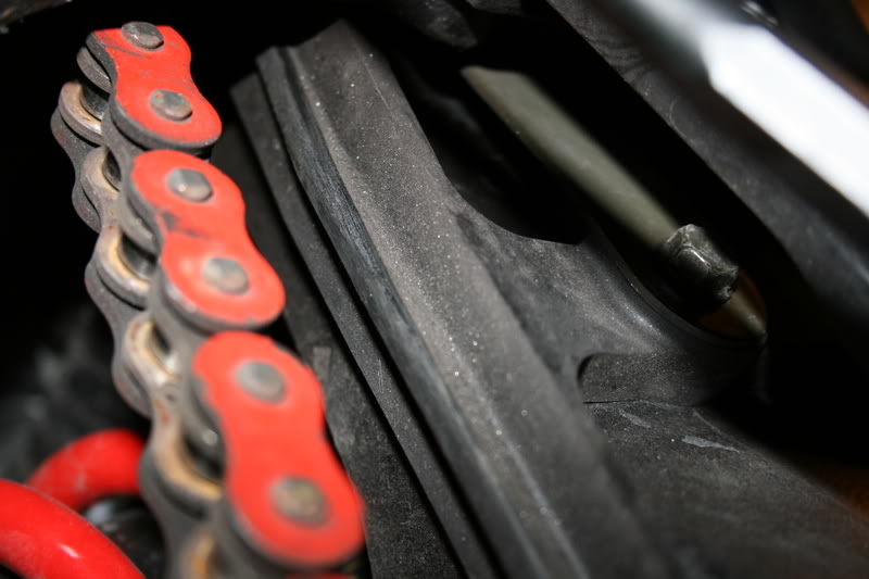

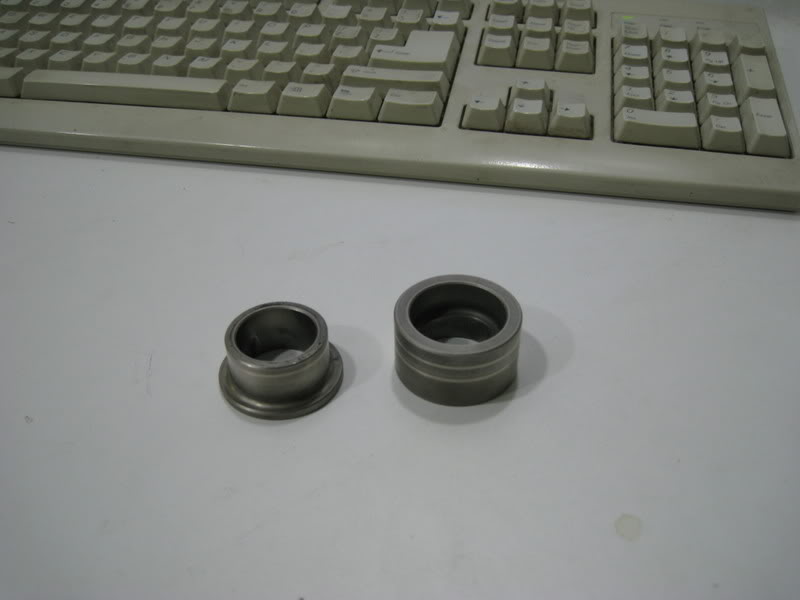

So these are the 2 05/06 spacers you should be running, one on each side + the caliper bracket and thats it......For reference the cush left side spacer has a 21.5mm width, and the right side spacer has a 18mm width...

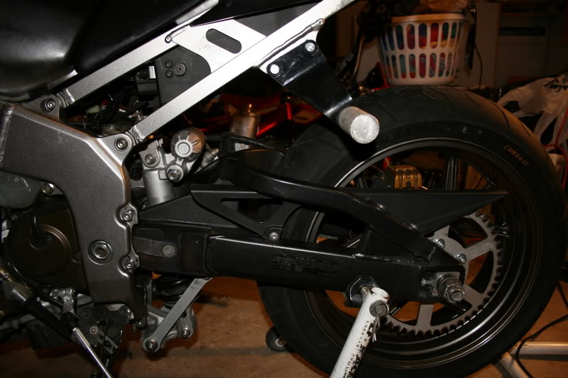

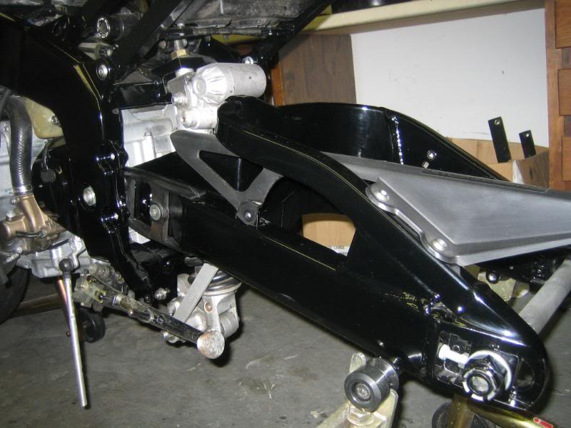

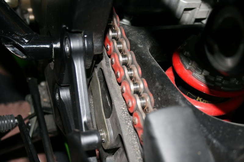

Heres a pic from when I coated tit.....03/04 636 swingarm on either end, 05/06 swinger on the left 05 ZX10 on the right...Looks close might work, but dont know how differnt the newer ones are...
It looks like the 07/08 636 ones would bolt right up like the 05/06

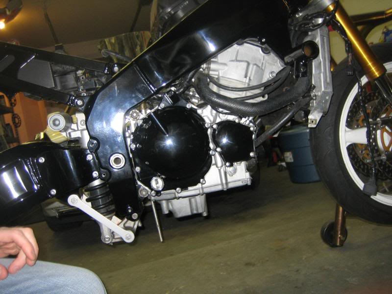

ok I did the 05/06 swingarm sawp on my 03/04
I think I used the wrong washer on the left side pivot bolt(the big one throught the frame) I couldn't fit the little bracket shaped kinda like the letter v with the little 6mm bolt with 10mm hex head.
the I realized that willie is probaly right about the 04 shock hitting.
So I just scored an 06 rear shock and lingage on e bay.
So when I get the shock and get the bike up in the air I'm gonna take off the swingarm and get some pics posted up of what i'm talking about.
I got all the 03/04 and 05/06 hardware just gotta figure out how that left side goes together.
I plan on using the 06 rear shock and linkage with dog bone arms but will use the 03/04 shock top mount like johnny says

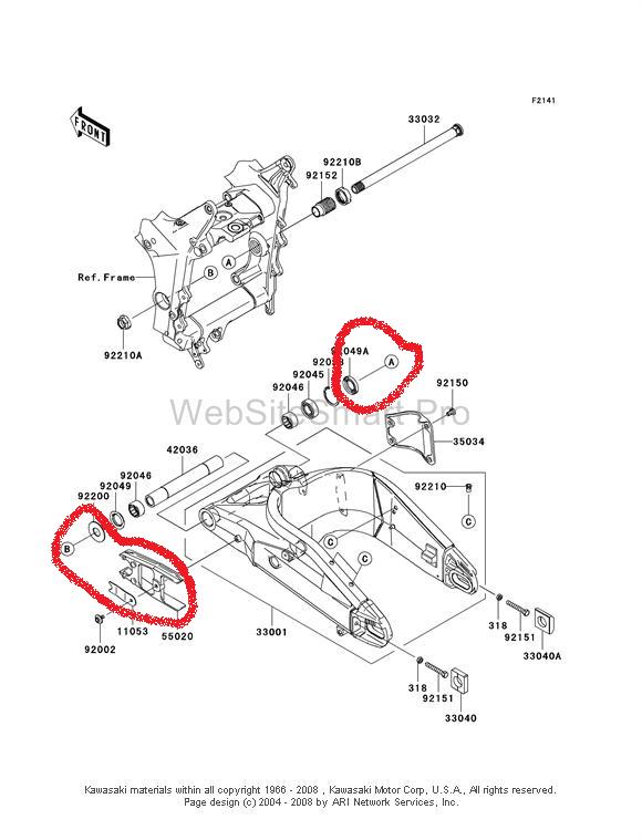

Old Jan 13, 2009 | 04:37 PM
  #52
Greg Mcglynn's Avatar
Posts: 1,277
From: bristol, patheticut
Greg Mcglynn is an unknown quantity at this point
Re: 636 rear wheel swap
I pulled a pic of the 05/06 setup. And circled the problem parts for me.
On the right side I removed the rubber seal that is circled. I replaced that with the 03/04 and slid in the threader sleeve for the axel bolt. That side is ok.
My problem is on the left side.
The washer on the end labled B with the arrow, I forget what I did but i think I did use that washer and put it in where it goes on the pic.
My problem was I couldn't fit the hold down clamp part# 11053. I couldn't get the swing arm to fit with it in there. But I noticed in your pics ***** you got it to fit. So something is wrong. I did get# 55020 chain guide ok just not the hold down clamp.
I gotta get the bike to my boys who has a beam I can hang it from the subframe and take it back off. I assembled the swingarm when I got my frame back from powder coating.

Old Jan 13, 2009 | 04:38 PM

Old Jan 13, 2009 | 04:47 PM

Old Jan 13, 2009 | 04:59 PM
  #55
Posts: 1,277
so all that stuff on the left side has to go in. I'm its something stupid I am doing wrong. I'm gonna try to slide that hold down clamp in there without taking the whole swing back off. stay tuned for pics

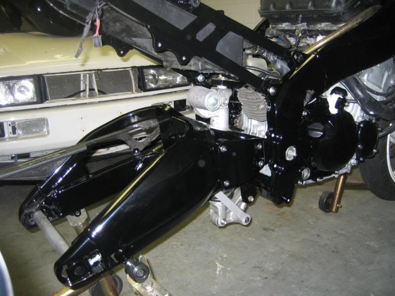

Old Jan 13, 2009 | 05:46 PM
  #56
Posts: 1,277

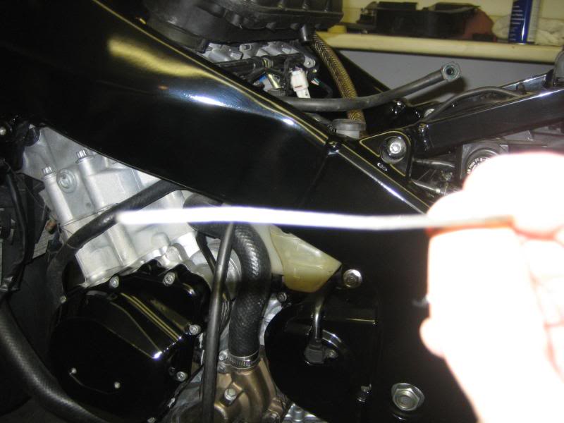

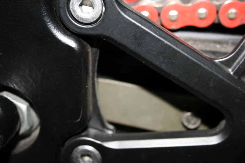

just tried again. No luck. The hold down clamp is hitting the frame not allowing me to line it up with the bolt hole
Name:	2009 paint 010.jpg
Old Jan 13, 2009 | 05:57 PM
  #57

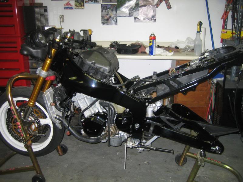

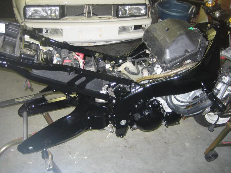

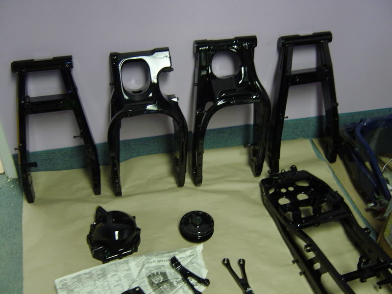

Here's the rest of the pics of the project on photobucket
Size:  76.3 KBName:  2009paint004.jpg
Size:  69.3 KBName:  2009paint005.jpg
Size:  67.0 KBName:  2009paint006.jpg
Size:  71.2 KBName:  2009paint007.jpg
Size:  45.6 KBName:  2009paint009.jpg

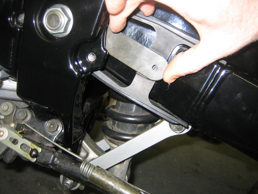

does the clamp go on the outside of plastic chain guide or inside. Don't know wich way the thing goes on its curved so it only goes one way.
I know I don't even need the thing but I want this to be perfect.
Old Jan 13, 2009 | 06:02 PM
  #59
Suicidl's Avatar
WWW.Sickinnovations.com
Posts: 18,216
From: Usa
try tapping it in with a rubber mallet. it should go in you just might not have it lined up right or maybe try pulling the rubber out and putting it in as one piece

Old Jan 13, 2009 | 06:03 PM
  #60
Suicidl's Avatar
Posts: 18,216
From: Usa
do you see how it has that bend in it maybe you had it flipped
