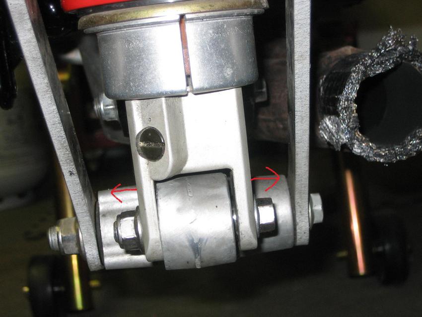

ok guys I am back at. Went and looked at an 06 bike tonight to try to make some sense out of this shock free play issue. My buddys bike's shock is nice and tight. Mine moves side to side. Both of the lower linkage pieces look the same. I checked the micro fiche picture and it looks like I am not missing a seal or anything. So weird.
I put arrows showing the direction I can move the lower shock side to side. It clunks. Its not right

so you have the 05-06 swingarm, shock ect. what lower knuckle are you running? if you use the 03-04 lower knuckle you have to swap out the seal i think i can not remember so i just used the 05-06 lower knuckle. i need to know what you used

They said the whole thing was from an 06. I compared the linkage to my 03/04 ones. They are different. The 03/04 has grease nipples and the 05/06 doesnt.
I also compared my linkage to my friends 06 636 last night. His bike is complete and has the rear wheel on it so it is hard to tell for sure but they look identical.
Except his shock is nice and tight and mine isn't.
Guess the next step will be remove my linkage and compare it to pics I can find on ebay or here. Maybe it has the wrong collar and seals in it(but why would it?)
I hear what you and johnny are saying about just using the o3/04 linkage and swap out the seals. I may do that if I have to but I want to use the 05/06 linkage.

Well my bike getting painted Monday so I had to get this problem solved this weekend. To make a long story short I totally stumped my self trying to swap out different seals to make that shock fit tighter. No luck. Then I went and brought my friends 06 636 over my house and took it apart to compare.
I compared my linkage to his and its the same exact part# and measured Identical.
S I am convinced I got all the right stuff. It has to be right. Then a friend of mine realized that the only reason why my shock has play in it is because the rear suspension is unloaded right now(on jack stands under frame.)
So we jacked up the 06 and bam problem was solved. His has the same side to side movement when we unloaded his rear suspension also. So this is totally normal and I am just super **** and retarded.
Thanks for everyone's help. End of thread

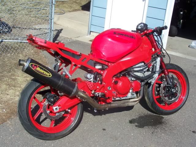

I just got mine back into 1 peice and running after powdercoating all the parts....
And No the tank and plastics will not be staying red....
