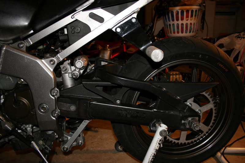

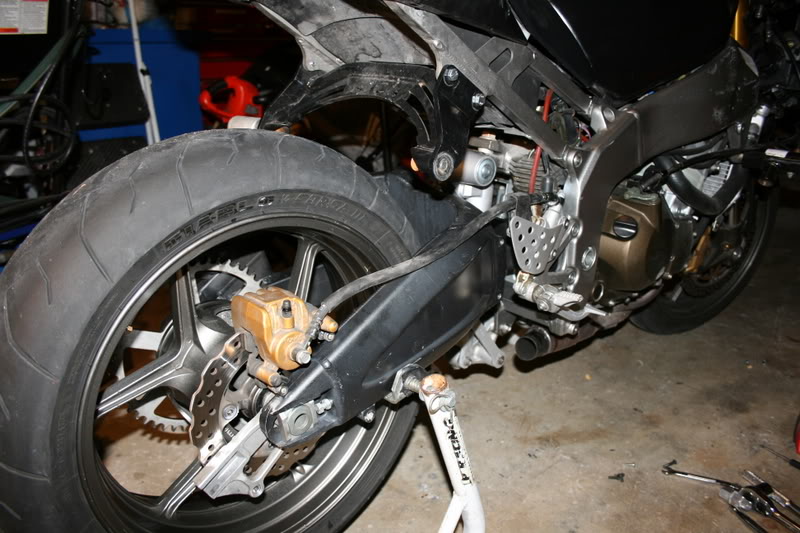

it was a easy swap to do thanks johnnyp for the instuctions

how the hell did you get the axle and brake mount so quick
Haha i just used the 03-04 axle with some washers and the 03-04 brake bracket to get it all aligned

ya i noticed it was long after i made the post...
