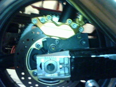

wheeliest i'm not trying to sound like an idiot but can I just take the lever and off grind down the piston without rebleeding the whole ****
Old Mar 23, 2007 | 07:09 PM
Re: Suzuki Radials For HB's
he is just telling you to take it apart to see if you have the problem

i can put my bike in third gear with the idle cranked up to 3500 and lock my rear brake with my pinky..........
yeah but dont you have like a front brake caliper hooked up to the HB?

I have the problem, there is no way that I could pull the lever with one finger and it feels real hard
yep:YEAH

Originally Posted by 1ST GEAR
^^ I thought I had the hotness going on mine.. dual rear calipers.. both dual piston... he's got the heyho setup I guess...
nope....

i knew i wasn't the only person whos had probs with em.
Originally Posted by AntwanRTTG
Just wanted to give you big props for your thread about shaving down the pushrod for the GSXR radial MC. I was having the same problem with the caliper locking up and it was driving me nuts. I had Bill from FTI on the phone like 5 times trying to figure out what the hell was wrong. I was just about to buy a new MC before I saw your thread, five minutes later ... problem solved. So basically, thanks alot bro.

Im illiterate and cant follow the 1st post, are you supposed to be able to blow through it?
Old Apr 3, 2007 | 02:20 PM
Wheeliest's Avatar
Scrapes Elbow
Posts: 8,833
From: Phoenix, AZ.
yeah you are. you should be able to blow through the resi hose and it should come out the banjo

I check both my front and HB mc's... neither one had the problem.. My problem was a weak *** arm.. and no leverage.. grabbing the lever 1/2 inch out cause of the shitty setup I had.. new clips, problem solved!

That has me wondering how in the hell it ever worked when I was using it for my front brakes. Anyway ... still the best thread I have found on SL.

wow this really works very well thanks wheeliest and omr for find a link into this thread ! it works wonderful now. thanks again

nope....
were did this come from ? is it home made and are they for sale?

my bad the pic of OMRs setup is what i was referring to
