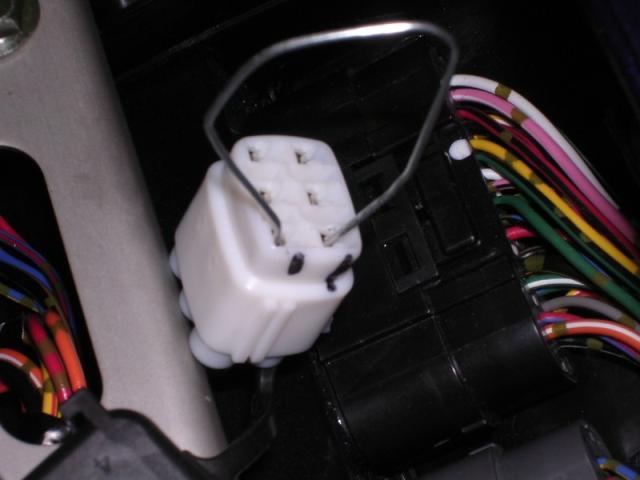

put it in dealer mode( there is a white plug behind the battery, and you will most likely have to slide the tail back some to expose it, it is kinda buried, mine had a little black rubber booty on it) to put it in dealer mode find the plug and use a paper clip to short out the two prongs on the side of the plug (these prongs will be directly over one another on the outside of the plug)
Check the pic - it will look something like this
turn your key on and a code will come up on the screen where the FI light originally was
here are the codes,
