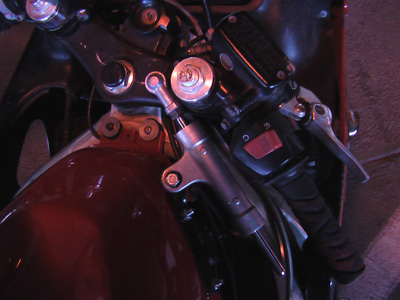

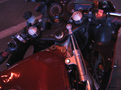

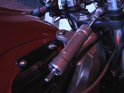

i ended up just bolting the rod to the top of the tripple. For the mount i used 1/8" x 1" stock steel, about 5" long. I just heated the end and twisted it so that it would be pointed the right way to be bolted up to the damper body. I fastened the mount to the edge of the tank using 2 - 1/4" bolts and put lots of epoxy in there (to help keep it tight and also to keep the gas from leaking). I put 20w fork oil in the damper. I haven't tried it out yet, but just from turning the bars back and forth hard, it looks like it should work great. The mount is solid.
nice work man :YEAH
you get it bled ok? no loose spots?

Thanks. I got it bled real good. There's just a very small bubble in there that i can barely feel when moving the rod by hand. I used a little rubber thing that looks like a light bulb (it's supposed to be used to feed babies medicine) to get the oil in.

haha :YEAH to get the last air out, just attach a vaccum hose to the inlet-keep the fluid ready to fill the damper, and move the piston super slow a few times.

the damper is tilted back at the same angle as the tripple (making the air move to the front of the damper), so even if there was a big *** bubble in there (there isn't), it would only affect the steering when it turned all the way to the left.
Anywho, i tried it out. That thing's pimp. I wasn't able to roll stoppies, though, because i have a battleaxx front tire. But it felt nice for everything else.
