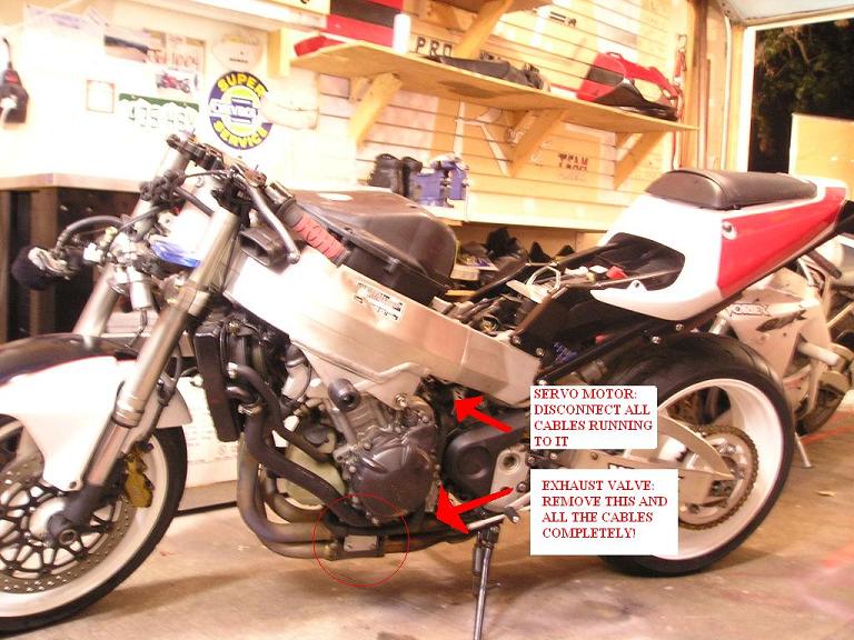

In picture #1, you can see where my exhaust valve used to be. You need to disconnect those cables and pull that valve out of the exhaust completely. Get a thin piece of sheet metal from Home Depot or a local hardware store and cut out a block off. (You can use the metal gasket that comes off of the exhaust valve for a template. Just trace it onto the sheet metal and cut it out). To seal the block off, I suggest getting "HONDA BOND" from any Honda shop. Works great, and you can use it for many applications on your bike. Now, follow the cables up from the exhaust valve to your Servo Motor, once you have done that, disconnect all the cables that go to your Servo Motor. (The Servo Motor is just a small, round looking box that controls the opening and closing of the exhaust valve)

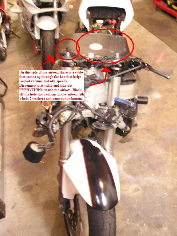

In picture #2, even though I don't have the airbox open, once you open up yours you'll see exactly what I'm talking about. You need to completely gut the airbox. Take out the flap, all the cables, and the cable that comes up through the bottom of the airbox, get rid of that. Now block off the hole in the airbox with a bolt, 2 washers (one on each side of the airbox) and a nut on bottom. Remember to put back in your airfilter after.

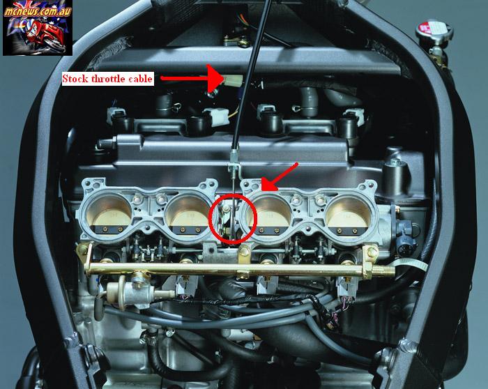

In picture #3, you can see these are the throttle bodies on a 954. Where the circle is and the arrow that points to it is, there is a very small idle screw. I shouldn't even call it a screw, its basically a threaded bolt with the head of the bolt cut off. You can see that it is set to a factory position to hold the throttle bodies open. What you need to do is take that out and replace that with a CBR 600F2 cable. These cables work best, but if you have something else then use that. If you get an F2 cable (which are like $15 or $20 at any Honda shop) you don't need the spring on the end. When I ran my idle cable I ran it back up, right next to the existing throttle cable (which is the upper arrow in this picture). On the bottom of your airbox you'll see there is a small valley for the existing stock throttle cable, so just run your new manual idle cable parallel to that. Be sure to lube the threads on the F2 cable with axle grease!!!!! This is important, b/c if you don't it will bind up over time.
This is exactly what I did to my 929 and you can manually adjust your idle now to any RPM with absolutely NO GLITCHES!!! Leave your existing vacuum cable connected and at your stock position. Your vacuum idle cable which is under your frame does still function and will control vacuum idle at start up, so don't disconnect it.. just leave it set so your bike idles normal. "Warning": The bike will start a bit rougher, be a bit louder, and if the bike is cold it will cut out at Wide Open Throttle if you get on it... but once the bike hits around 150 degrees she purrrrrs like a kitten!!! If you have anymore questions, Email me or pm me. I'll do the best I can to help you out.
