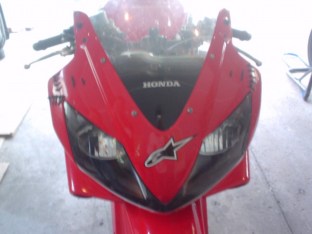

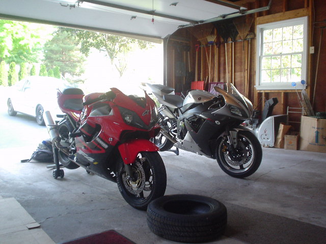

I assume u sold ur 954 and still just chillin bikeless? All I got on my comp is pics before the krylon job and shiz no vids or pics of anything mostly because I aint got shiet worth showing.
ID:	156630   Click image for larger version
