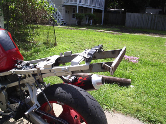

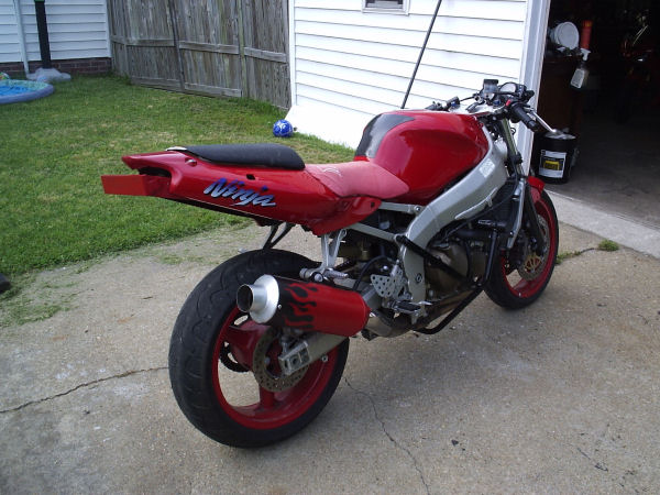

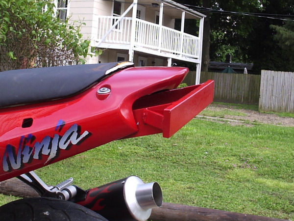

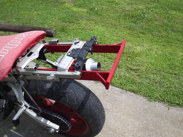

I'm not real sure about the placement, I have also heard that the best way to learn 12's is without a bar. I built one for my bike (haven't had the time to test it yet), and I went straight up from the rear tire, so it shouldn't have any problem parking! I used a 2' level to figure out where I wanted it, I also used a torpedo level to mark where to cut the steel so it should be flat when I 12 it. Doing it this way didn't leave any room for my foot to fit on the 12 bar during stunts, so I guess I will have to use the rear peg a lot, or remove the rear seat. I guess if I need to I can alway re-drill some of the holes and extend it backwards.

ok, let me try it again....Here are the pics of my homemade 12 bar for my 2000 ZX6R. Maybe someday I will find the time to actually get out and see if it works!!!
